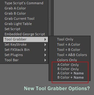

Posts: 1579
Re:New "Tool Grabber" options
New Tool Grabber Options.jpg (21.21 KiB) Viewed 28725 times
As I thought about David's question (and the current options for color palette buttons...) it occurred to me that adding a few options to the Tool Grabber might be worthwhile:
In addition to grabbing both APen and BPen colors together and automatically creating the "A color dot/B color background" button, a user could create a button that would grab just the APen color or the BPen and make a solid button displaying only that color.
Then I thought, if the user also wanted to be able to NAME the color in the process, why not offer an extended Tool Grabber option that immediately lets him/her insert a name for the new color button?
In fact, if it is possible to include an automated naming option, it might make sense to offer a naming alternative for all the Tool Grabbers???
Sven
Re: Collecting colours in a panel
Sounds doable and smart.
Please post in the feature request.
It would be for the 11.0.4 though, with other color related stuff. The 11.0.3 is about to be released.
