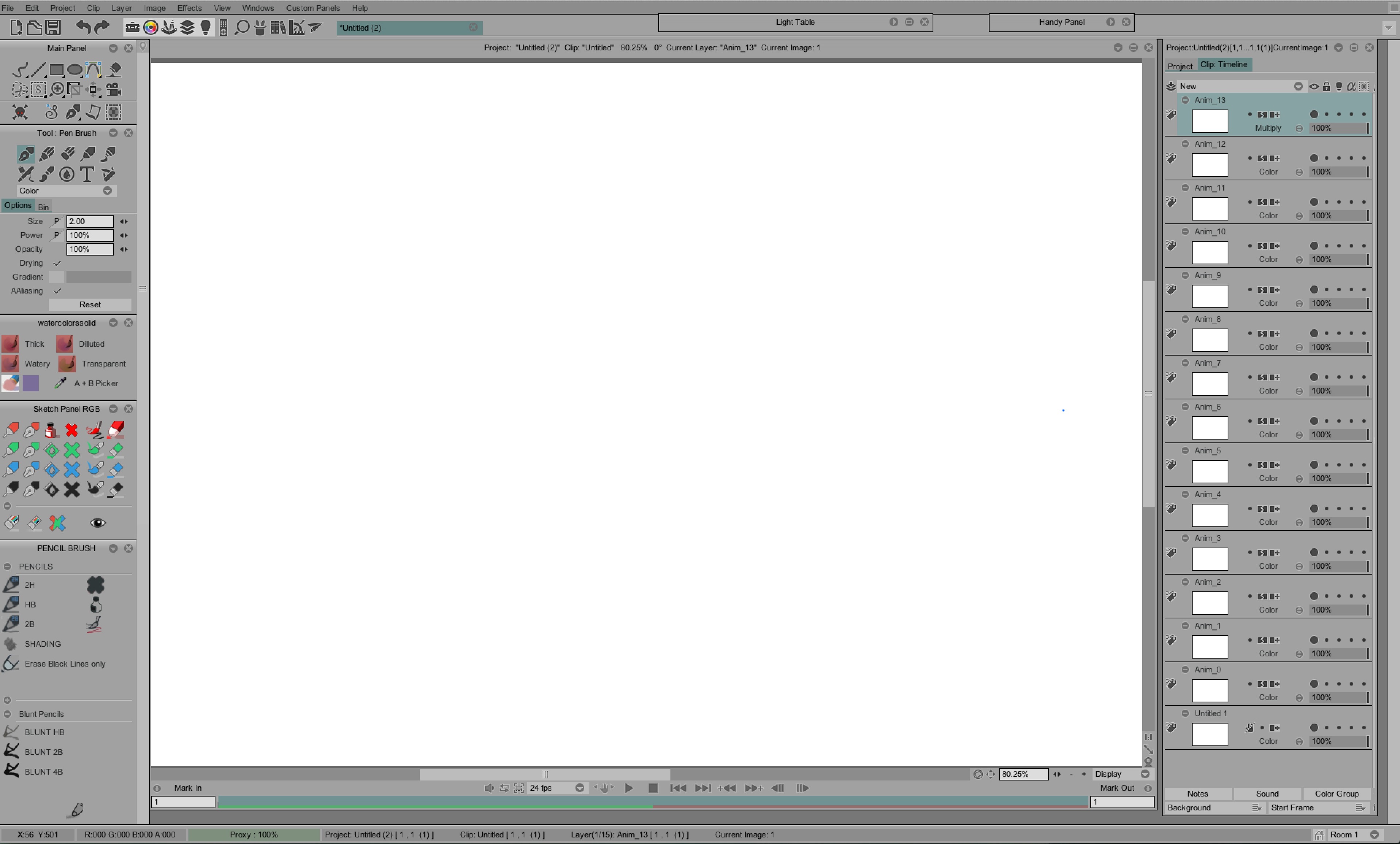

I just had this conversation with a student who was asking about: "using TVPaint for illustration , but with the timeline out of the way and layers set up more like PS", so I showed him how to set up one of the Rooms like this :Elodie wrote: I'd rather advise to unpin the timeline and resize it to display layers only, without frames.
(click to see image larger)
Then it can be easily switched back to one of the other Rooms view that has "normal" display of Layers and Timeline set up for Animation.
One thing I'll mention re: "unpin the timeline" , this isn't always apparent to the new user how to do this. (that is, to "unpin" the timeline)

OK great! I never really understood how the Vertical Timeline worked before. I don't usually use the Right Drawer, so this works perfectly. Thanks!

So how can we unpin the timeline? Thanks!

Just doubl click on the top of the timeline to unpin itbluecarrot wrote:So how can we unpin the timeline? Thanks!

But for the person who doesn't come here to the forum and happen to read this discussion , how do they know there is any such option as "unpin the timeline" by double-clicking on it ?Elodie wrote:Just double click on the top of the timeline to unpin itbluecarrot wrote:So how can we unpin the timeline? Thanks!
In the User Manual a search for "unpin timeline" or "unpin" turns up no results.
Where it is described in passing is here: http://www.tvpaint.com/doc/tvp11/index. ... exceptions" onclick="window.open(this.href);return false;
which refers to "floating timeline" :
"To change the fixed window into the floating window, double click on the window's title bar."
"To change the floating window into the fixed window, click on the pin in the top right corner of the timeline window."![]()
