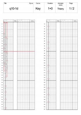

What does it do ? It scans all of the visible layers in the current clip and stores the instances heads and image marks (and the instances names but it seems there is a little bug here).
When you load the panel, there are two buttons : "Sheet Key" and "Sheet Inbetweens". They were asked by a user in Japan. Their core functions are basically the same, but they do it differently. I will explain the differences later.
Let's concentrate on "Sheet Key"
So, let's show 2 examples.

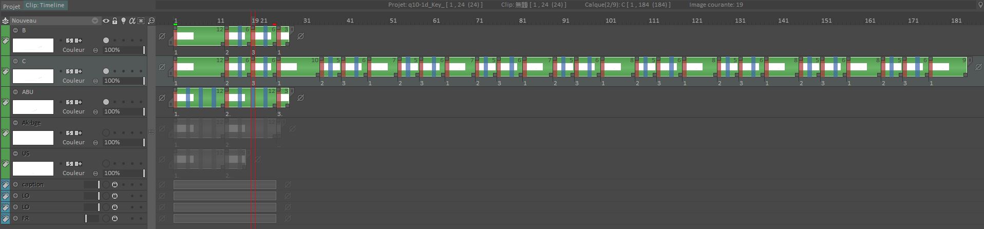

Let's take this timeline :
9 layers, 3 of them are visible, 184 images.

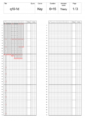

When clicking on "Sheet Key", the script will scan the layers, then draw a table. This will be the result :
The script produces a new project named Timesheet with the following dimensions : 3748 x 1324 (A3)
What do we have ?
At the top :
  • A field named Title containing the project's name, and a field named Ep.no left blank (was requested by our Japanese user)
  • A field named Cut.no, containing the characters between the first "_" and second "_" characters in the project's name (was requested by our Japanese user)
  • A field named Duration, containing the duration, calculated like this : Integer division of total number of frames by the frame rate + the rest of the images.
  • A field named Animator name, filled with the Author's name.
  • A field named Page, indicating the current page of the Timesheet.
All of these information can be edited by modifying the DrawProjectInfos() function located in the sheet_key.grg file. (Important : if you don't have any experience with George scripting, or coding in general, it's not advised to modify the sheet_key.grg and sheet_inbetweens.grg files !)
The main part :

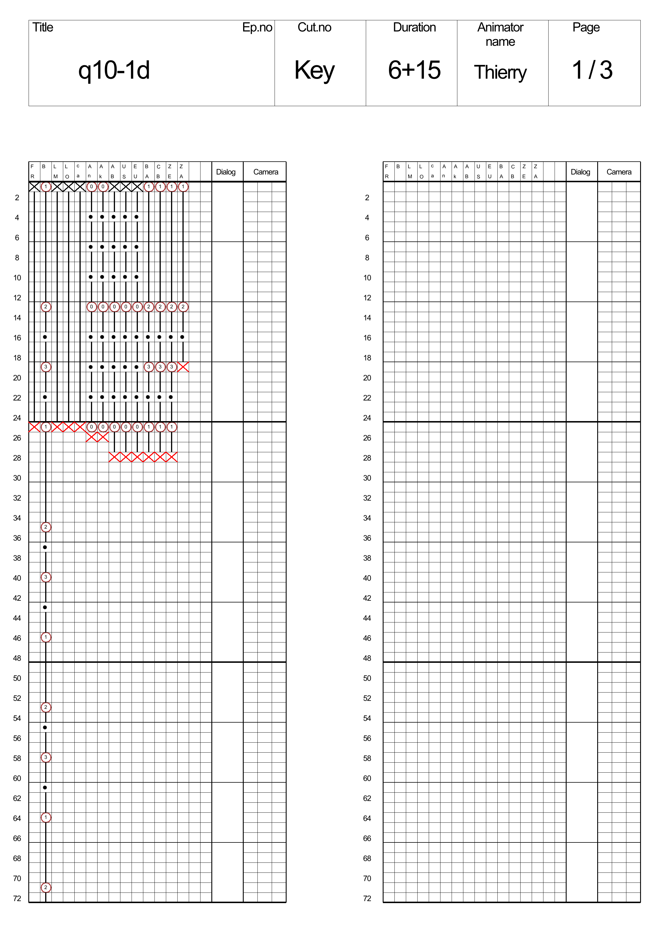

We have two identical tables, organized as follows:
  • In the first 7 columns, the name of the instances heads that have an image mark are circled in red. For now, it is only "0". Obivously, it's advised that the names of the instances should be numbers, and not words (otherwise it can't fit).
    The exposures are reprensented by a black line.
    Exposures having an image mark are reprensented by a black dot.
    The first two characters of the layer name are on top.
  • There is a column named Dialog where you can write informations about the dialog. The script does not fill this column.
  • The column at the right is used by the "Sheet Inbetween" script. I will come back later to this.
  • The last column, named Camera can be used to write informations about the camera. The script does not fill this column.
  • You can see a red line : it represents the Mark Out value.

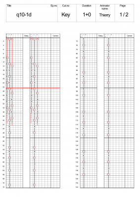

Now, if you have more than 7 visible layers in your current clip, the script behaves differently.
Here is the result in that case :
(there are still 184 images)
  • 16 layers and 72 images can be displayed (instead of 7 layers and 144 images).
  • The Dialog column is near the Camera column.

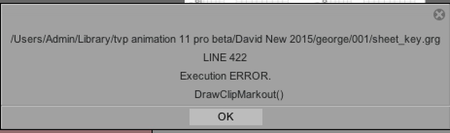

There is execution error 'DrawClipMarkout()'
with markout set on the first frame.

Re: Timesheet
There should be an updated version 7.3
Thierry will post it.
We are still in the process of improving the script.

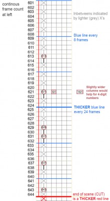

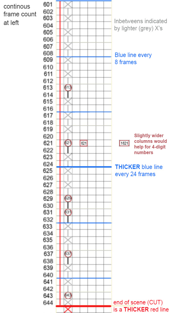

I have a few suggestions:
1.) Please have the frame count at the left side be continuous frame count
(1, 2, 3, 4, 5, 6, 7, 8, 9 , 10 , etc. instead of 2, 4, 6, 8, 10 , etc. )
2.) wider columns so 3 and 4 digit numbers are more readable .
3.) the red circle around the Key drawings (Image Mark instances) is slightly larger for better readability with 3 and 4 digit numbers.
(Perhaps Key drawings could be denoted by a RED BOX (rectangle) around the Key frame numbers rather than a circle ? )
4.) inbetween frames are indicated by a lighter (grey) X . (or inbetween frames are numbers , but the numbers for the inbetween frame are in light grey . Keys are in BLACK , circled in RED .)
5.) Thicker BLUE line every 24 frames.
6.) Blue line every 8 frames .
7.) End of Scene ("CUT" line) is a Thicker RED line .
Posts: 2815
Re: Timesheet
D.T. Nethery wrote:I have a few suggestions:
7.) End of Scene ("CUT" line) is a Thicker RED line ..
Doable without any issues.
D.T. Nethery wrote:2.) wider columns so 3 and 4 digit numbers are more readable.
This will be very tricky to do, as everything is calculated to fit with the size of the columns.
I can widen them, but not by much. I'll see what I can do.
D.T. Nethery wrote:3.) the red circle around the Key drawings (Image Mark instances) is slightly larger for better readability with 3 and 4 digit numbers.
I don't think I can make the red circle larger without widening the columns, as the circle already fills the squares.
However, having a red rectangle around the key frame numbers is a good idea. I'll see what I can do (shouldn't be hard).
D.T. Nethery wrote:4.) inbetween frames are indicated by a lighter (grey) X . (or inbetween frames are numbers , but the numbers for the inbetween frame are in light grey . Keys are in BLACK , circled in RED .)
Having them in a lighter gray shouldn't cause an issue.
Re: Timesheet
Thank you ! That would all be very useful. If the red rectangle around the key frame numbers is doable I think it will help with readability for three and four digit numbers . And if the columns could be slightly wider it would make the three and four digit numbers more readable.
