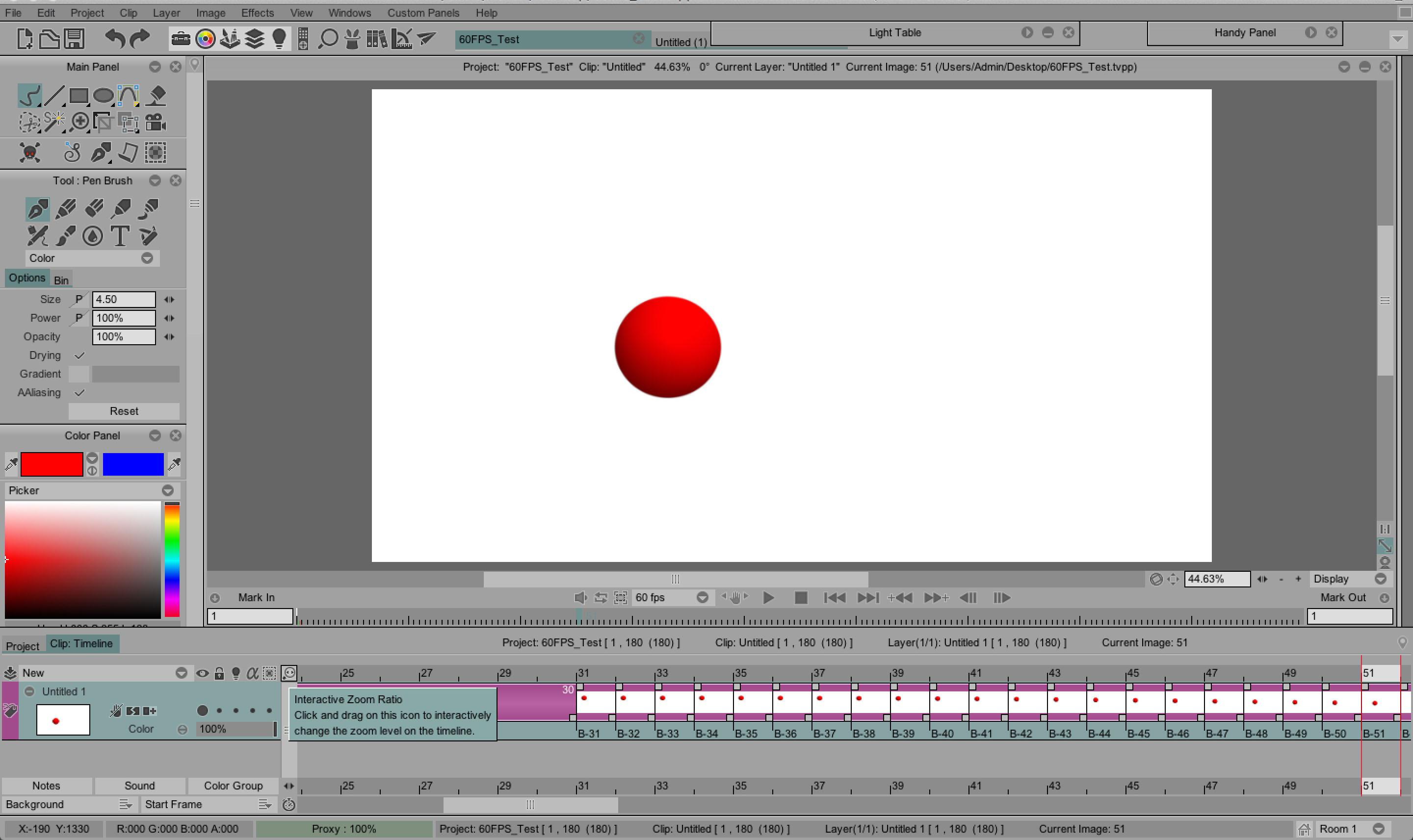

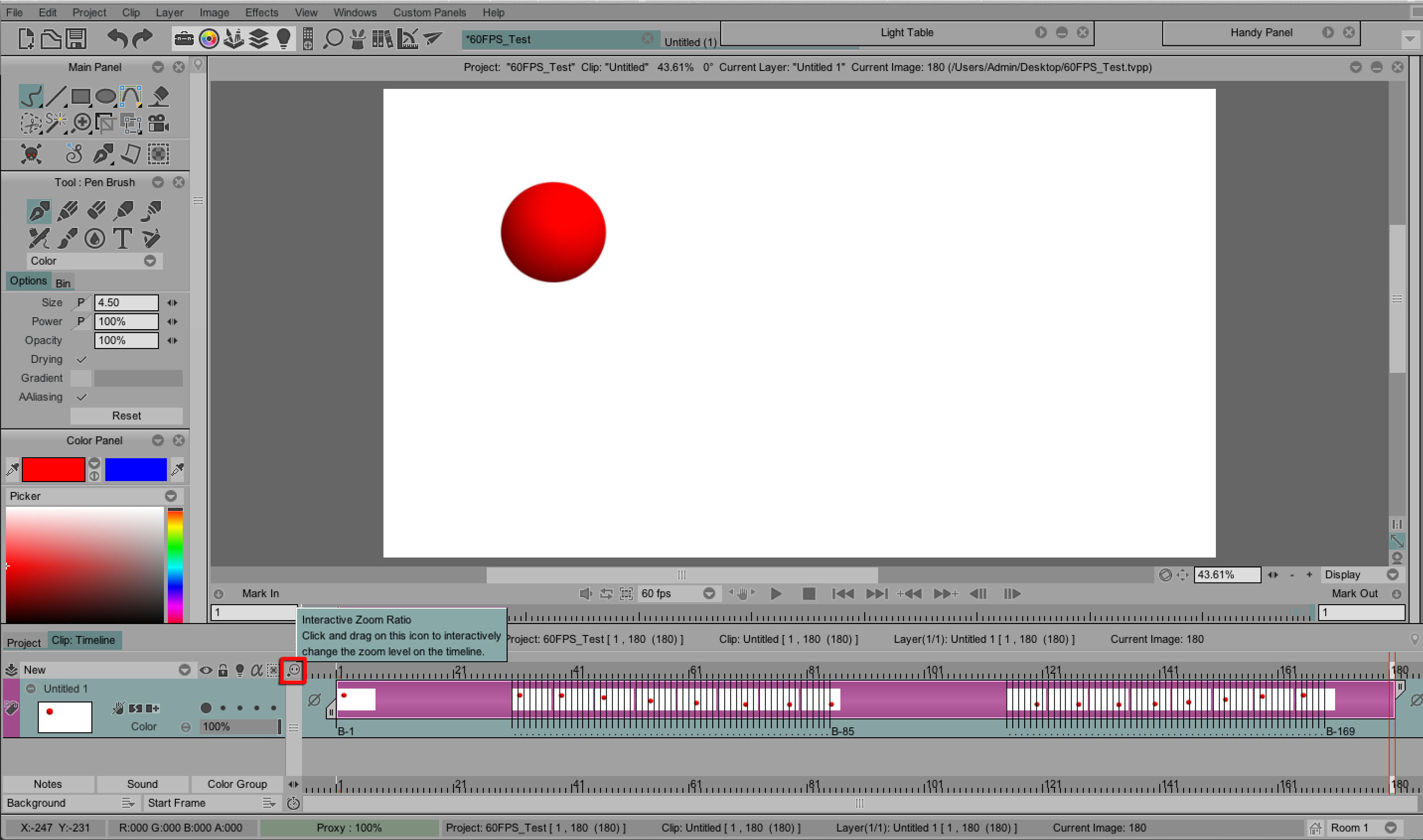

I'm not sure you entirely understand how the interface works or what Frames-Per-Second refers to. When you say "I can barely stretch it to 60 FPS before it disappears from the timeline" what do you mean by "it" ? Stretch what ? Do you mean the exposure of the instance(s) on the Timeline or the FPS rate of the Project ? In your first screenshot you have ONE instance exposed for 15 frames on the timeline ; in your second screenshot you have ONE instance exposed for 50 frames . So what do you mean "it" disappears from the Timeline if you stretch it to 60 FPS ? FPS doesn't change how frames are displayed on the Timeline ; FPS refers to the frame rate of the Project , not to how many frames an instance is exposed on the timeline or the size of the timeline display , so your statement seems to be confusing two different functions.TheQuestionMark wrote:
http://i.imgur.com/j7XG0rW.png" onclick="window.open(this.href);return false;
I can barely stretch it 60 FPS before it disappears the timeline.
See the attached screenshots and the attached .tvpp file . My first screenshot shows a project that has a frame rate of 60 FPS , and the project duration is 180 frames. In the first screenshot I have compacted the zoom ratio of the Timeline so that all 180 frames fit on the Timeline . (this is independent of the frame rate of the Project ... it could be 60 FPS, or 30 FPS , or 24 FPS). If I wanted to expand the display of the frames on the Timeline then I would click and drag on the magnifying glass icon to expand the zoom ratio of the Timeline view as in the second screenshot. But again, the compacted or expanded display view of the instances on the Timeline is not related to the frames-per-second rate of the Project.

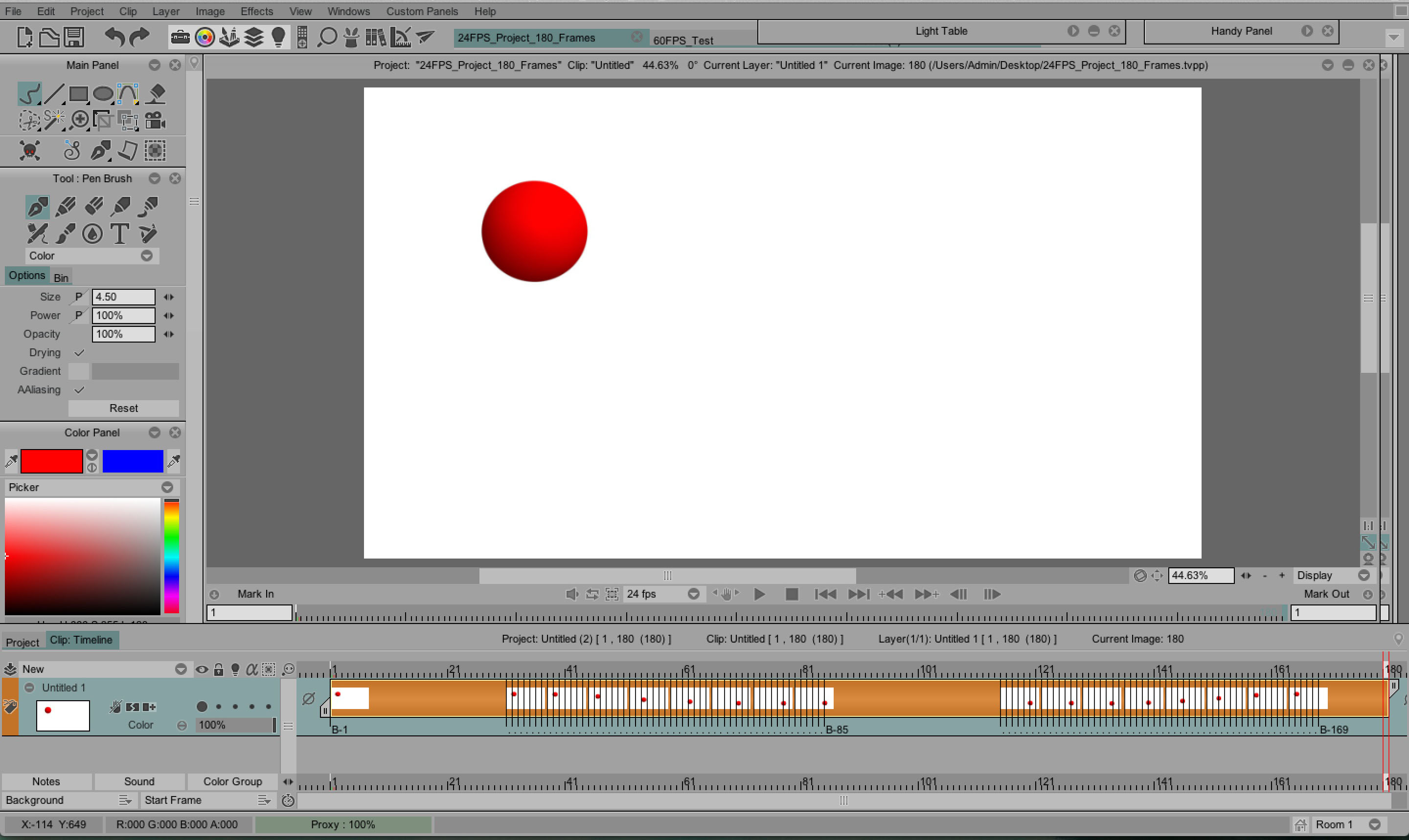

(click the images to see them larger) But see that it is the same if my Project frame rate is 24FPS . Here is the compacted view of the Timeline , for a project that has a duration of 180 frames , with a frame rate of 24 FPS -
So you see that expanding or compacting the Timeline zoom ratio display of the instance(s) on the Timeline has nothing to do with the FRAME RATE of the project (60 FPS , 24 FPS, or otherwise).
