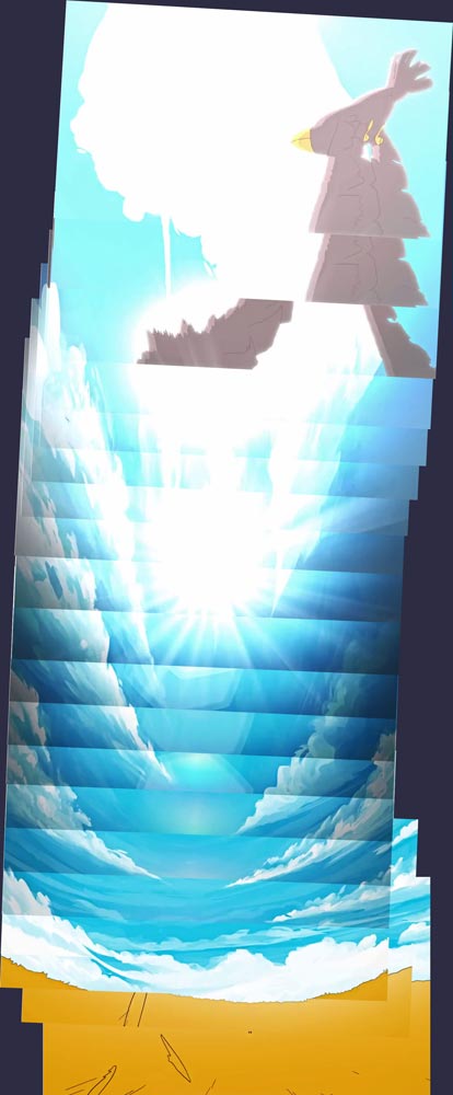

At 1:17 ofr me it's only a dezoom of a multiplane camera, the background is drawn on multiple layers that you can clearly discernate
Re: In this video, how did they make this plane look 3D?
Uhm, no. It's really just 1 painting of a sky. Only the horizon is animated to indicate the distortion of a wide angle lense pointing upwards. Everything else is just a camera pan plus some glow and lens flare FX.
See: (This way of painting in distorted perspectives is demonstrated several times in "The Illusion Of Life". Seems that not many artists today still know how to do this.)
As for the rays of light: of course there will be dozens of plug-ins out there to do that. But it's much faster to just animate it by hand, like I did it here (it's supposed to be under water):

I wasn't talking about this part of the video. I was talking about the black and white layout at 1:17. I guess i misunderstood something somewhere
Tanks for the explanation anyway. You see it a lot in japanese animation i think
