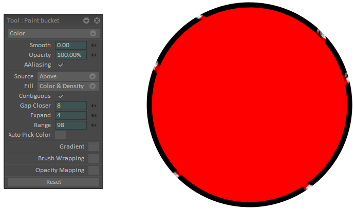

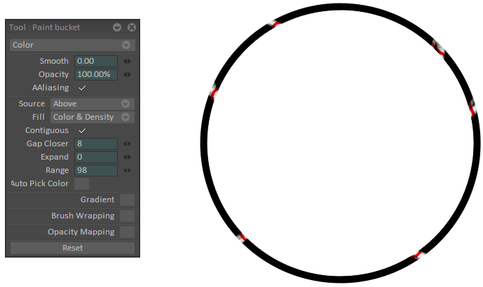

an idea upon reading this:
Couldn't you make a script that fills with a gap close and expand "on", and then automatically after that, fills again but now with erase and without the expand so that the result is a line that lies under the drawing AND closes the gaps. when you use a bright contrasting color it can function as a gap marker.

Re: Gap Detection But Not as Fill Tool But as Marker/Guide T
What about using a CTG layer (much better than the fill tool at detecting gaps) with a border FX on it and applied to another layer? Using kind of the method described by peter above.
