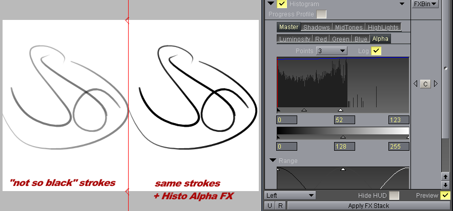

just for info, another alternative is to apply an Alpha correction to "harden" the drawing's opacity,JQuinn wrote: ... I forgot to duplicate the levels to make it darker! ...
(Keying/Alpha Control or Histogram/Alpha FX)
it's particulary interesting when you want to control the blackness of the line layer along the timeline,
f.i. during a camera zoom-in or out.

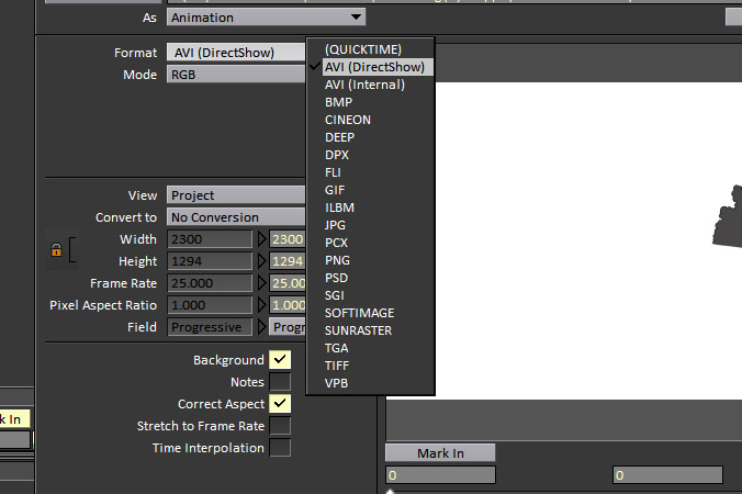

HEllo everybody.
I hope it is the right place to post this question.
I´m working for a client on a project. And my client is on mac and I am on Pc.
Projct size is :2300x1294. 100 frames on ones.
Every time I try to export the 100 frames and do the playback,size 100%, in quicktime player, the line is destroyed.
When I playback the animation ,size 100%, in windows media player I see nothing wrong.
I have attached two pictures.
One showing the export settings and one showing the destroyed line ( only visible in quicktime player)
Any help is greatly appreciated.
Thanks in advance.
Regards
Anim.

What is your OS (which version of Windows) ? What is your version of TVPaint ? (Help menu > about TVPaint Animation)Anim-Illustrate wrote: I´m working for a client on a project. And my client is on Mac and I am on PC.
Project size is : 2300 x 1294. 100 frames on ones.
Every time I try to export the 100 frames and do the playback,size 100%, in Quicktime player, the line is destroyed.
When I playback the animation ,size 100%, in Windows Media Player I see nothing wrong.
SEE: viewtopic.php?f=10&t=6167" onclick="window.open(this.href);return false;
Re: What are the best settings for working & exporting proje
The Quicktime player will not play anything larger than your actual monitor resolution (the old version 5 player could!), so please check if your display can actually handle 2300 x 1294.
OK, your screen resolution seems fine, Quicktime should be able to open the file 1:1. Now I wonder which codec you used for the video? The artifacts look like you used something like AVHD or the like, which are totally wrong for animation. Could you render the video with Apple ProRes and look again?

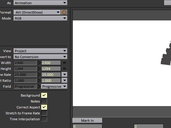

slowtiger .
This is how it look when Exporting the file.
As I recal, I have always used this setting when exporting "stuff" to my clients.
And never had any issues.
Do you have any idea about this?
