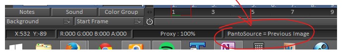

Posts: 1579
Re: How to create a brush with Panto source setting?
Soom wrote:This script is working, except, that I don't see any notification - where is it suppose to appear?
Infobar = Information Bar which runs across the bottom of the interface...
Infobar - Information bar.jpg (22.16 KiB) Viewed 28492 times
Thanks for the workflow details. I'm glad you asked about assigning Panto source - I didn't know about that George command and it will come in handy! :D
Sven
Soom
Posts: 1205
Joined: 25 Jul 2011, 16:25
Location: World
Post by Soom »
My infobar is empty... (TVP 10.5, Mac OS 10.10.5)
