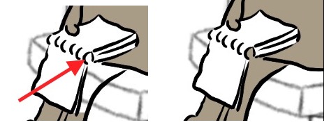

Hi Paul. I tried the Exclusion option, but it does not work as it then excludes too much, so I have to then repaint what it has exlcuded, but it also fills in the space again and I'm back where I started. I am attaching an image. The arrow points to the circle which I would like to paint white. The circle at the end of the rings on the pad of paper. The easy thing would be to change to a manual brush and paint that area in, but I can't see how to do that on a CTG layer.

The CTG is meant to be used as a speed fill tool. What you show here needs to be done with a drawing or painting tool. For that you need to flatten the CTG layer back into an anim layer by pressing the letter A on your keyboard (Layer: Make Anim) after you have finished with fill (or before you start filling).. BTW, CTG layers take up a huge amount of memory so they should always be flattened after having done their work.

Right. That's exactly what I was looking for. Didn't know I had to flatten it to do that. Where is this vital info to be found, but not for you, Paul? I can't see anything about it on the online manual.

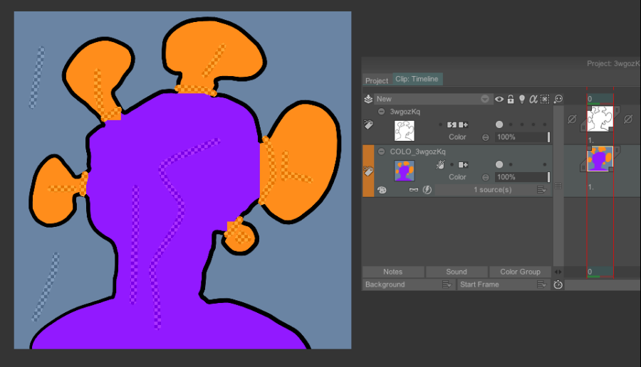

Hi everyone
I'm also dealing with this and and this is what I did.
In this extreme example:
If I just want the little spore-like part to be colored, or say, to be filled with different colors without touching the black outline,
This is what happens usually:
So I create a new anim layer here called "color adj"
and make sure both the outline and this layer are listed as CTG's sources.
Then use the filled color to makes some edges in this "color adj":
And there you have it.
Hope this helps.
Might not be the smartest way tho.

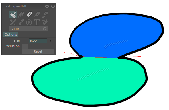

thats a good solution.
but this does make it much harder to do color adjustments afterwards.
one of the benefits of using the color & texturelayer
i'd like to request an extra tool in the color & texturelayer panel
see image: where a close gap tool is added to the Speedfill toolpanel and you just put thin UI lines to closeoff leaks.
The lines (like the squiggles) will not be visible in render or when the C&F layer is off or inactive

You can also close the lines with CTG directly :
