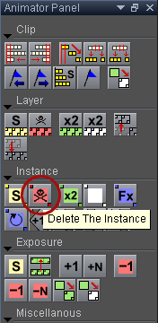

Not sure that it worked this way already in V9, but in 10 you can do that with the animator panel- the skull button of the instance menu deletes the current instance. You see, instances and exposures aren't the same thing. An instance can have more than one exposure, if you delete one of them, your instance isn't gone, and if there's just the instance without additional exposures, the delete one exposure command won't do anything, and rightly so.
Hope that helps, good night.

If you want to delete totally one instance, you can directly use the "DEL" short key on your keyboard. It will erase the instance and delete the all instance from the Timeline.

Layer:Delete Image works for me (in TVPaint 10 and 11).
Even better, it works for all of the following:
1. deleting the current image, whether it is an Instance or an Exposure, whether selected or not.
2. also, it works for deleting a selection of images (it is smart, too, about turning exposures into instances where it makes sense).
3. also, clicking multiple times nicely chews away images, one at a time in quick order.
I have assigned Layer:Delete Image to Ctrl Del shortcut so i know my frame deletions are intended.

basically all you need is to learn how to make good use of the Animator Panel,
[Delete Instance] is one of the commands included in it,
once this basement acquired, you will be able to go further,
by adding customized tools, and assigning the most frequently used to shortkeys at your convenience.
