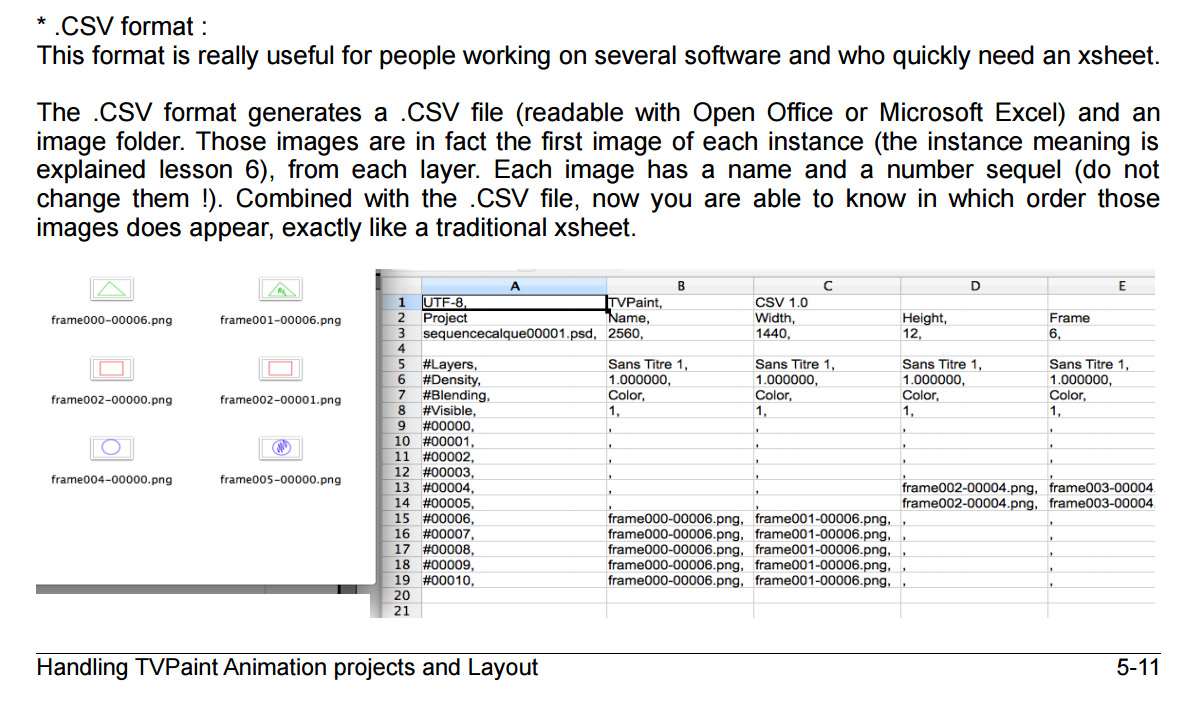

and about export xheet file(.csv) , xsheet is not intuitive
I think it better that express units digit(ex. 1,2,3,4,5) . not complex number (ex. frame 000-00006)
