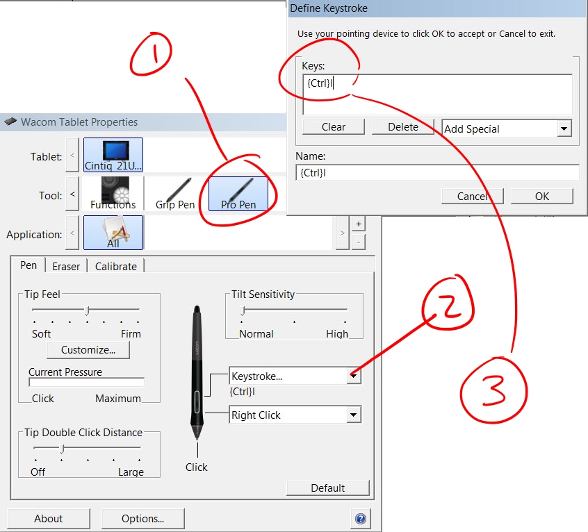

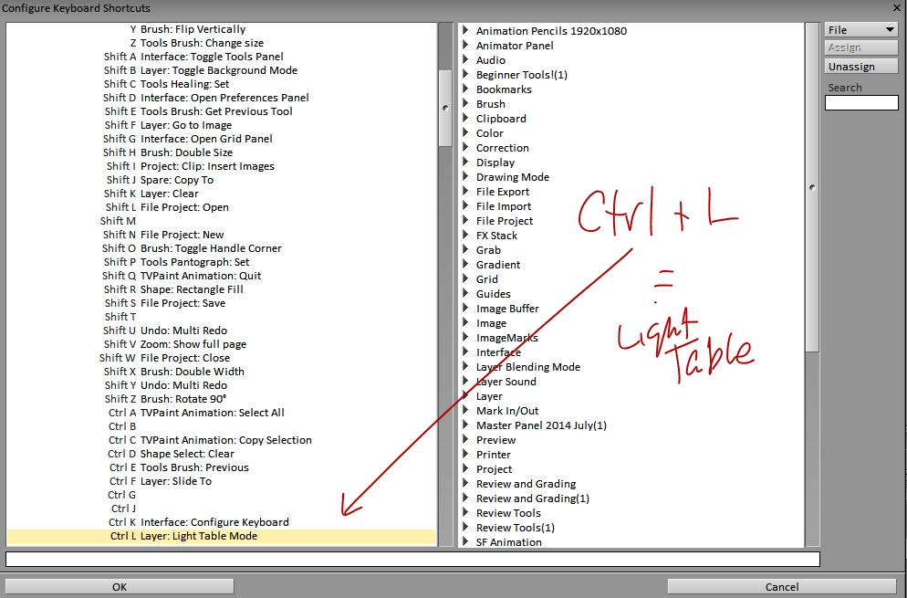

Make CTR + L (which I set up as my Toggle Light Table command in the Preferences) the function for the upper button and then the upper button with ALT allows you to rotate the art (because it reads CTR first).
CTR + L as the "toggle light table" on the upper Cintiq pen button is THE most useful tool for animators I have ever found. It allows you to (almost unconsciously) turn your light table on and off, which you do all the time with key animation. It sure is faster than reaching under the traditional table for the lamp switch!

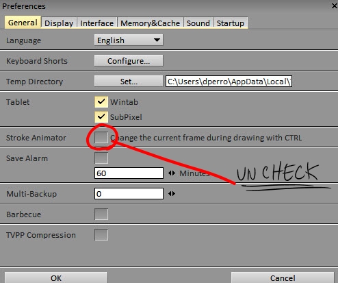

Note: If using this set up, make sure you go to Menu Bar: Edit/Preferences and turn OFF the "Stroke Animator" or you will scroll automatically through your timeline when trying to rotate your art.
