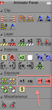

I was thinking about the possibility to clic and drag to change the exposition of a frame
I would just use this:
Bildschirmfoto 2014-04-27 um 12.05.35.png (30.61 KiB) Viewed 9223 times
You can set it to a keyboard shortcut.
I think it is more precise then clicking and dragging and also faster.

Already done it with + and - :) and more (for the exposition i set my numeric keypad to have the exact same exposition that the number i press, and go to next instance). I'll post my custom panel soon...
And yes, thinking about it it's kind of faster. But hum, when you have your all timeline and want to manage exposition, instead of going at this frame + use your shortcut, if you just use clic and drag where you want without having to move on the timeline (and with the two different fonctions of the squares), maybe it's faster? I think it's why i sometimes prefer to use the squares instead of + and -.
