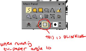

I set the a random angle of my Current paper with this script
Code: Select all
newAngleVAL = RND(360)
tv_paper "Angle "newAngleVAL
What I dont understand, and what I consider as a misbehaviour in tv_apper is that the "Enable/disable paper" button in the main panel is blinking when running the code. Which mean the function tv_paper is enabling disabling the paper when running the funciton. but I have not asked for this. only to set a new angle. so this means that "tv_paper" is running slower than it could becauase it is doing stuff tit is not asked to do. And if i use George scripts and keyboard command when switching tool this gives an annoying lag when I shift tool.
