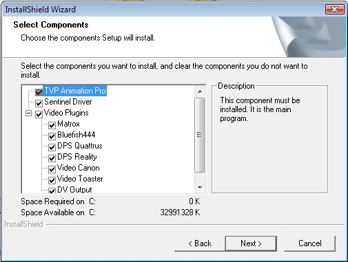

I have GRP version 8.1.1 installed on windows Vista, and when I run the installer and choose 'modify', I get no "tvp thumb". I used to get it with the previous tvp version I had installed on xp, but now i don't know where to find it.
I've tried to uninstall and reinstall, but through the setup I didn't find the tvp option.
is there a way to just drop a .dll file somewhere in the system to get thumbnails working?

Hi Asaf, the thumbnail dll is included into the "Main program" option. Have you try to re-install it?

You won't see anything refering to this since the dll is automatically installed.
Try to make a research on your system about TVPThumbnail.dll and check if it is correctly copied onto your system.
Please let us know then.
