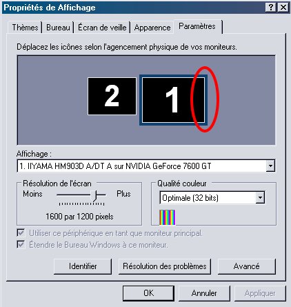

You mean this...<br />is this enough info for you?
You mean this...
or this, which is how i work now.<br /><br />( i know... i'd love to buy one of them wide screen wacoms)
lemec

The first image is perfect -- you won't have to use a stretched-wacom mapping -- this tool will make it unnecessary (I hope)...
Unfortunately I don't have a triple-monitor setup although I could probably jury-rig something if there's enough demand for it...

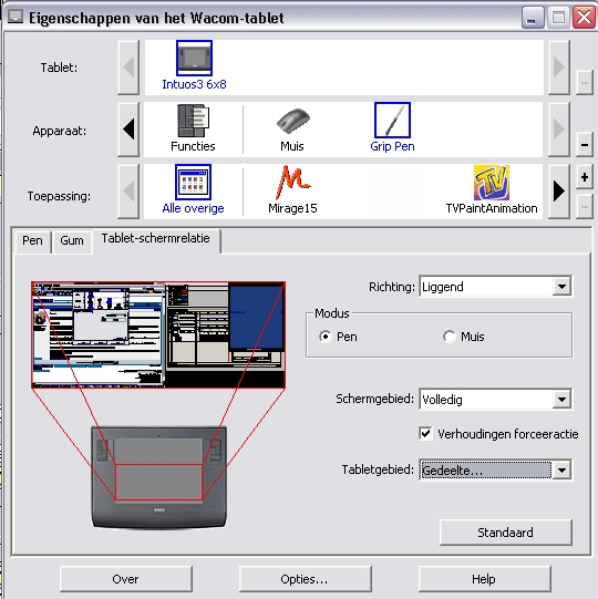

as usual, excellent idea Mark !!!
here is the panel for my wacom intuos3 (driver version : 4.93-3)
(same mapping for each pen)

However, if you move the cursor into the other screen using the mouse, it will automatically remap the stylus to the monitor the cursor is in!
Sorry, it does not work here. :cry: the cursor always come back to my monitor 2.
I can hear the sounds when I move the cursor at the right edge of the monitor 1 (see below) but there is not sound when the cursor move between monitor 1 and monitor 2.
