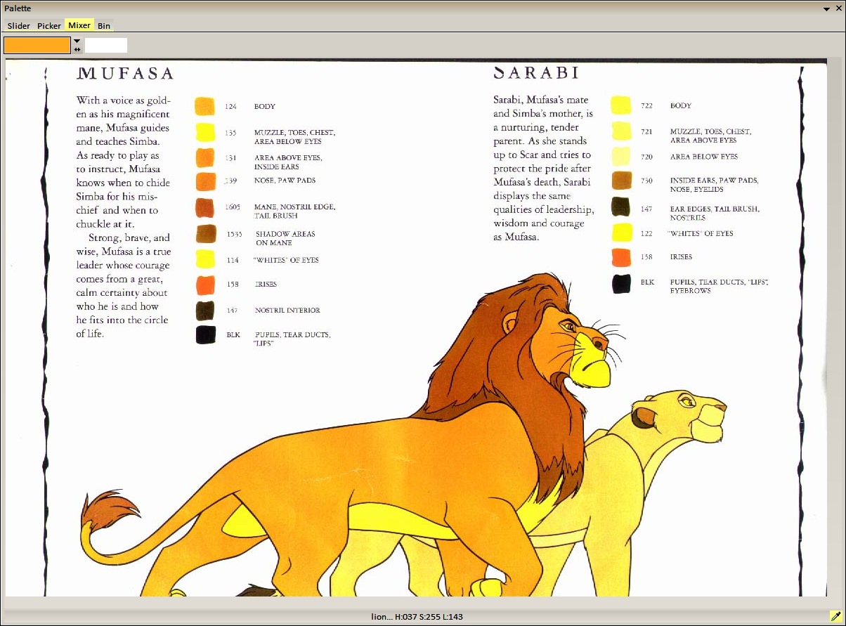

another example:
Re: Palette Mixer improvement
once again, when we will work on the palette, everything we re-think and rebuilt.
