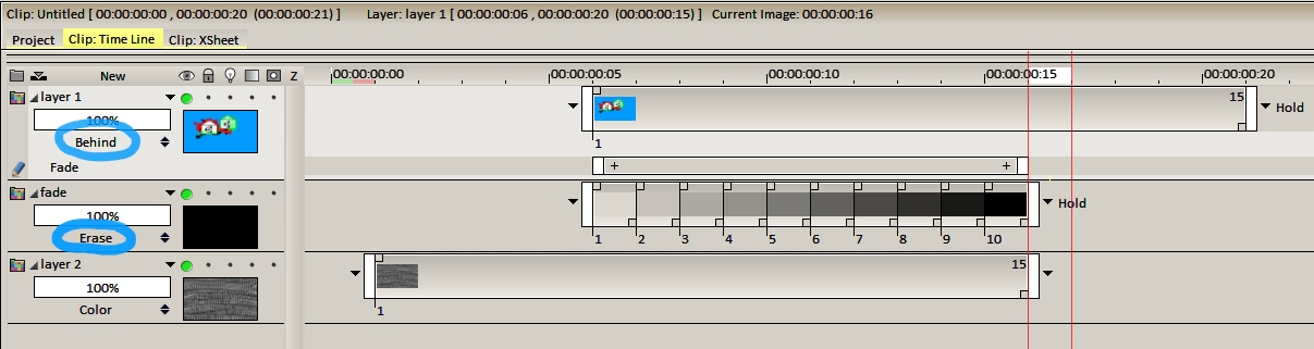

actually you can do a cross-fade by using the blendmodes, its slightly counterintuitive and you do need an extra layer
but its not destructive (other then having to reset the blendmodes of the layers involved.)
this is how:
the behind mode puts the top layer virtually under the bottom layer where its revealled because the bottomlayer is increasingly being erased by the fade layer.
Re: Temporary Fade
Peter, this is so cool! I have up to now never found any use for blend modes in my pipeline so I would have never thought of doing this. What a neat trick and thanks for posting the screen grab too.

Peter Wassink wrote:actually you can do a cross-fade by using the blendmodes, its slightly counterintuitive and you do need an extra layer
this is how:
Smart solution!

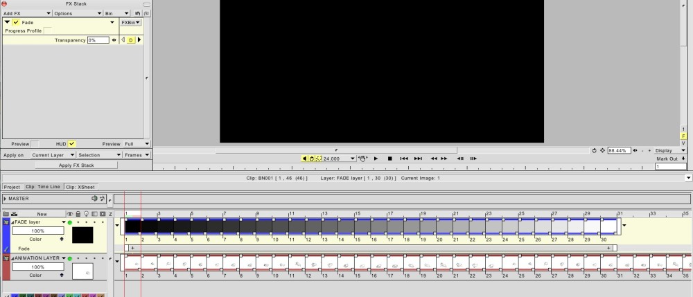

The method suggested by Slowtiger is the best way , but I would suggest that you don't have to duplicate the image or layer on a separate layer and apply the Fade effect to the duplicated image layer . Instead I would suggest you create a NEW LAYER , the new layer has a single frame -- fill it with solid BLACK using the paintbucket Flood Fill tool, then stretch it out to the desired length of the Fade (fade-in or fade-out) , in this example let's say the fade is 30 frames , although it can be any length you desire . Now apply the Fade FX to the new layer in either direction , depending on whether you want a Fade-in or a Fade-out ( from 0% - to - 100% for a Fade-in / from 100% - to - 0% for a Fade-out) .
This creates a Fade effect over top of your original layer which does not add a lot of extra data to your scene file (because you mentioned: "I also do not want to add another layer to my file as the file has gotten very big with too many layers to work with." ) and it is Non-Destructive to the original layer underneath . You can change the length of the Fade effect if needed by simply re-doing it on the separate layer or remove it entirely if desired . The original layer remains unaltered.
I have a set of pre-made Fades of varying lengths (8 frames, 12 frames , 24 frames, 32 frames , 48 frames , 60 frames, 72 frames ) saved as TVPaint Project files (.tvpp) , which can be opened up as needed and the Fade effect frames Copied & Pasted into my working project file on a new layer when I need to add a fade effect. Selecting the Fade level and then Right-Click >>> Reverse Selected Images can change it from a Fade-in to a Fade-out . If for some reason I wanted a fade longer than my "long fade" of 72 frames a simple trick is to drag out the Fade layer and select Stretch-Interpolate to lengthen the fade .
