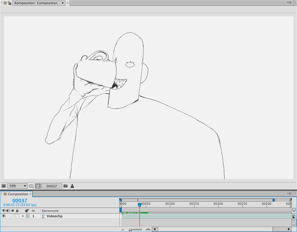

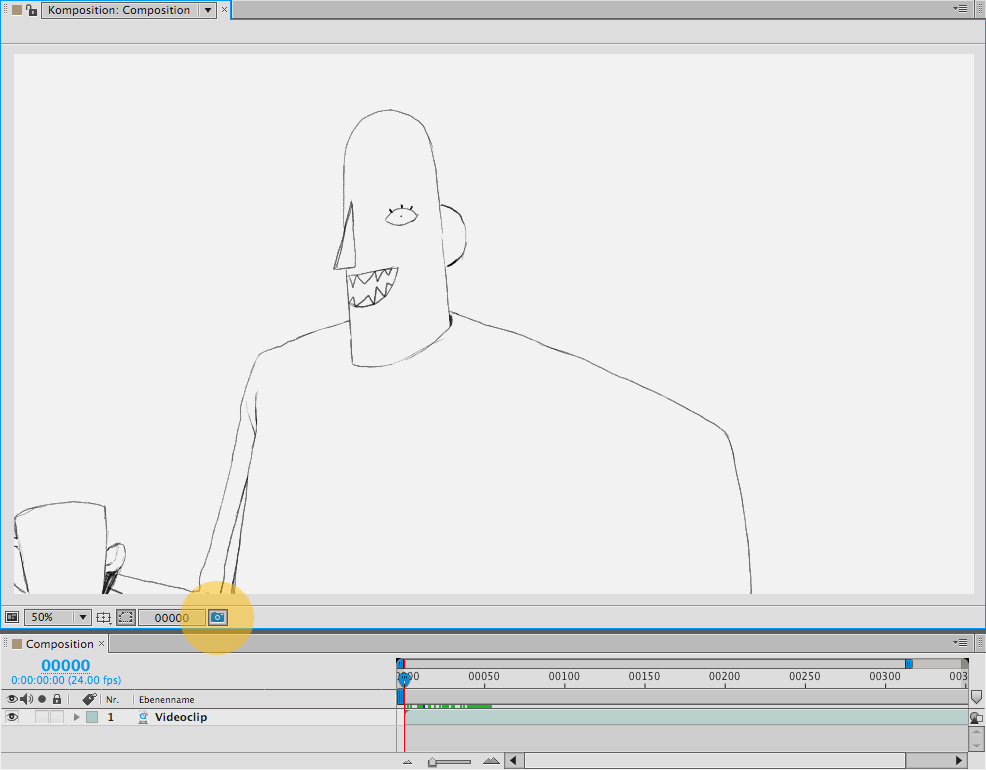

1. In my example I'm on the first frame (#0) and take a snapshot of the current work area, by clicking on the "take snapshot" button.
Taking a snapshot in After Effects
2. Then I go to any frame in my clip (in this example frame 37)
Going to frame 37
Going to frame 37

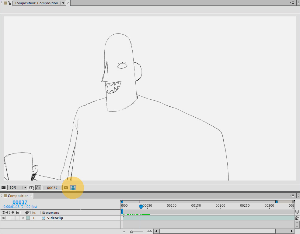

3. There I click on the "show snaphot" button, which appears after taking a snapshot. Now the snapshot is shown as an overlay as long as I click the button or hold the shortcut.
display a snapshot
display a snapshot
This could all be achieved by creating a bookmark on the first frame and use shortcuts to switch between bookmark 1 and 2 I guess, but with the snapshot-tool you can display your saved frame, even if you changed your work area completly, cause it's something like an intern clipboard, which only contains one image.
