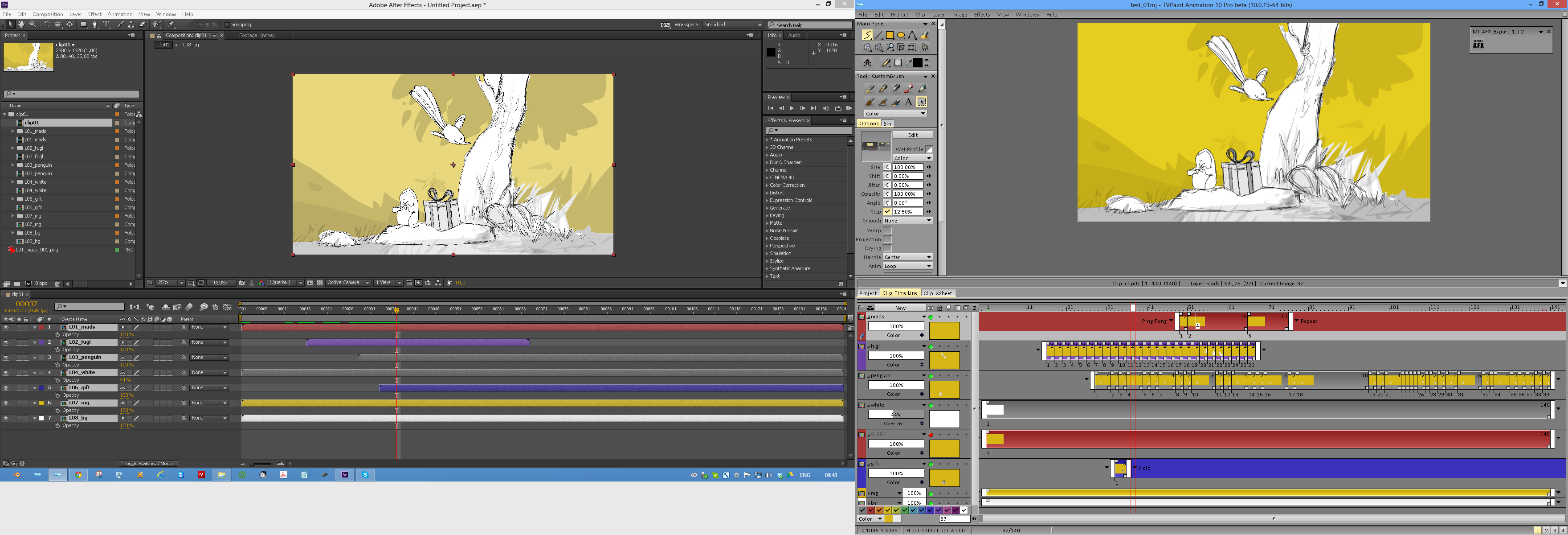

Here Is a screen shot of how the Clip Looks in TVPaint And how it looks after import in After Effects
