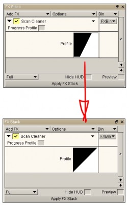

I use Scan Cleaner quite a bit, and I have saved my own personal settings for it within the FX Stack. It would be great if I could turn this into a button on my custom panel, but I can't find an option within "add action" to add a specific FX Stack item. I tried exporting the setting from the FX stack and then importing it as a custom panel, , but that didn't work. Any ideas? Thanks! --Sherm
Posts: 4501
me too.
i ALWAYS have to set the default graph to a straight line.
i think that default was created to clean up an average pencil drawing, and discard of light smudges etc..
but i always want to keep all the information from the scan and only remove the white.
so.... i would also like to find a way to either change this default or make a 'real' paper-cut custom button.
Re: How can I make a "Scan-Cleaner" button?
ramblindawg wrote:... It would be great if I could turn this into a button on my custom panel, but I can't find an option within "add action" to add a specific FX Stack item. I tried exporting the setting from the FX stack and then importing it as a custom panel, , but that didn't work ...

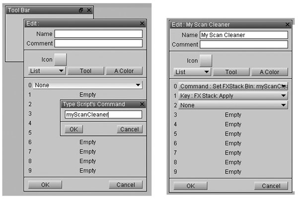

oh very easy, only 2 steps :
- first, adjust the profile of your ScanCleaner_FX and add the Bin as "myScanCleaner" (upper button, see pict.1),
- then create a CP button with these 2 actions : 0 = Set FXStack Bin: myScanCleaner, 1 = Key: FXStack: Apply
then "OK" and it's done, your new button is ready to use!
ps: if it's for a full animlayer (with X frames), add a "Key: Layer: Select All Images" before the "Key: FXStack: Apply" command.
(see pict.2) 8)

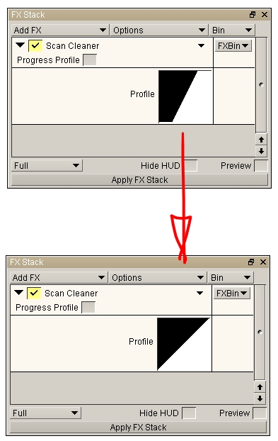

That's awesome...it WORKS!
Post by ramblindawg »
ZigOtto wrote: oh very easy, only 2 steps :
That's awesome...it WORKS! I really appreciate that, Zig...I'm sure it will be helpful to many others too. VERY very helpful!
When you said, "create a CP button with these 2 actions : 0 = Set FXStack Bin: myScanCleaner" I was stumbling on that for a bit until I realized I had to TYPE a command in the #0 box where it said: "Type Script's Command." I had never done that before. Then I chose the key command as you said into the #1 Box. I'm just spelling this out for other people like me who have no experience with typing command-line instructions. I have added some screenshots of my own to show the additional steps. Enjoy!
