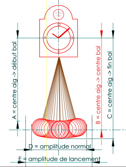

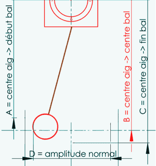

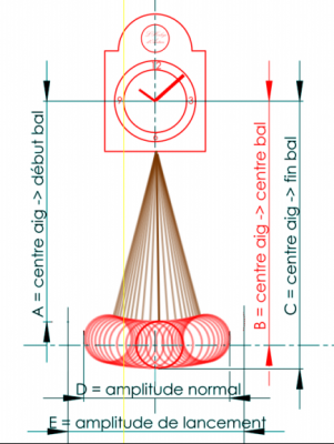

well, I've apparently missed what's the meaning of "LB" ...? :?
maybe you are refering to "Light Box", which is called here "LT" (for "Light Table"), ...?
anyway, at your place, I would go an easier way to get this pendulum move : make an anim-template by using the KF,
then, if you want to keep a handdrawn aspect, draw over this template, in a new animlayer.
more detailed procedure :
grab your pendulum (animated part) as custombrush, set the pivot to the top,
in the KeyFramer_FX, set your custombrush as Source, position it on its axe,
set 2 keys in the anim timeline, the first key (bank) rotated say to -15°, the second one to +15°
set the progress profile curve to a "S" shape, select All + Apply .
you will get a very consistent pendulum animation as template,
the arc path and the spacings being auto-generated,
of course, you can adjust the bank rotation amplitude and the global timing to fit your wish,
then freehand-draw over like when rotoscoping, (draw one on two only if you are animating in 2's).
