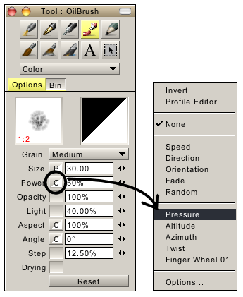

on the other tools it is "Power" that is the one you should connect to pressure. then I think you get the wanted effect

In fact, Opacity is the limit of Power.
We usually advise to users to only modify Power and let Opacity at 100%.

That's not precisely true - it doesn't work for oil-brush and wet brush, and partially for pencil (it also triggers other behavior as well), and also airbrush is not as well controlled as it could be...madsjuul wrote:on the other tools it is "Power" that is the one you should connect to pressure. then I think you get the wanted effect

As I answered to Mads - it doesn't work the same for all tools.Elodie wrote:In fact, Opacity is the limit of Power.
(even in fact, Opacity and Power could be merged, IMO...)
I'm taking Photoshop as an example - there is the Flow and the Opacity, and both control different functions, which is great. Flow in this case = Power in TVP - is the amount of tool value, applied over time, while opacity controls transparency. IMO they should not be united - on the contrary - I think they should be elaborated and pen pressure controlled on all tools. I think combination of opacity and power control can make brushes much more customizable and naturally subtle.
Do you mean the custom brush editor? I told already in the beginning, I know I can change it there, but well - it's only for custom brushes... I can't edit the other tools like that...? And by the way - there is no Power control in this editor, which is strange...Elodie wrote:Yes, but it can be managed via a Profile Editor, can't it ?

You are rightSoom wrote: That's not precisely true - it doesn't work for oil-brush and wet brush, and partially for pencil (it also triggers other behavior as well), and also airbrush is not as well controlled as it could be...
This must be a bug!!!
or am i misunderstanding the concept of the power??

No, I mean Profile Editor :Soom wrote:Do you mean the custom brush editor? .Elodie wrote:Yes, but it can be managed via a Profile Editor, can't it ?
Don't forget to use the pressure connection on power and disable it on size to see the difference. I don't have problems with pencil, neither airbrush nor wetbrush. But I agree, there is a strange behavior with oil-brush.Soom wrote:That's not precisely true - it doesn't work for oil-brush and wet brush, and partially for pencil (it also triggers other behavior as well), and also airbrush is not as well controlled as it could be...

Oh, that one, sorry misunderstood. Yes, it is a great feature for setting pressure-function ratio control, but it still doesn't solve the opacity-power issue, mainly cause there is no Opacity control, so there is nothing to edit...Elodie wrote:No, I mean Profile Editor :
Of course I did, but again - it only lets me control the density of the tool, not the opacity - I think it's quite different, although might be unnoticeable in some cases. Same with the pencil.Elodie wrote:Don't forget to use the pressure connection on power and disable it on size to see the difference.
In other words (as it was said here already) - Opacity should control the overall transparency of all pixels, while Power controls the density that pixels lay on the surface over time. I suppose that would be the most proper use of both.
