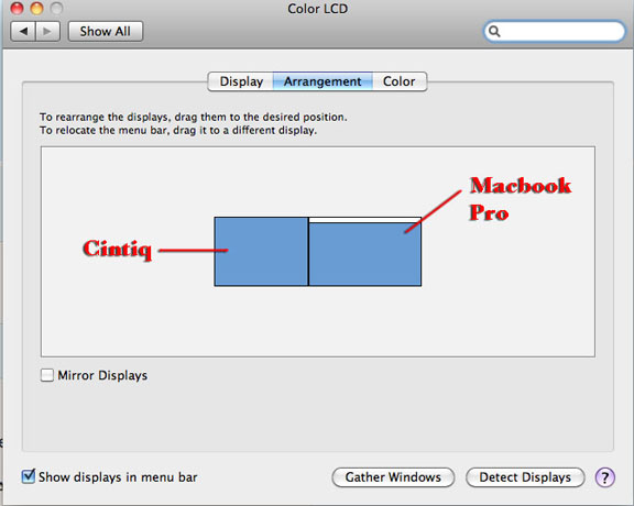

Here is one more thing to try:
In System Preferences make sure your Display arrangement is like this:
Soom
Posts: 1194
Joined: 25 Jul 2011, 16:25
Location: World
Re: TVP doesn't remember window position (on Mac)
Post by Soom »
D.T. Nethery wrote: Here is one more thing to try:
HO HO !!! That Worked! :) Wouldn't ever think of it! I wonder - what's wrong with the Cintiq being on the right side? I hope not political reasons :)
