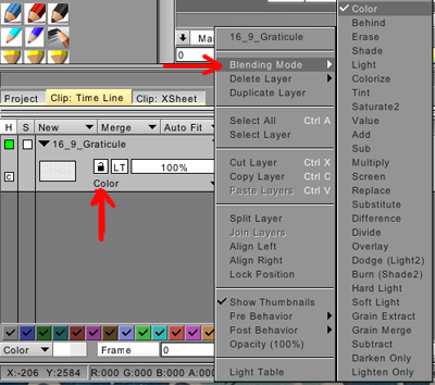

I just animated an assignment for school, when I accidentally pressed something. Now my animation has been cleared off the main sketching window, AND I can't draw on it anymore. The layer is at 100%, and I know it hasn't been deleted because I can still see the animation in the little frame thumbnails. Please help, I can't afford to lose this D:

Here's the first thing I can think of: Under the slider that says 100%, what label do you see? You should see the word "Color" but if you see something else, such as Lighten Only, you won't see the drawings. If you are lucky, all you need to do is click on whatever word(s) and select Color and your drawings should come back.

Ditto what Paul Fierlinger said above. He's talking about the Blending Mode. If you accidentally set it to something other than "Color" mode then you may not see any images in the project window (even though you know they are there because you can see them still there on the frames in the Timeline)
Here's what it looks like:

THANK YOU! I had accidentally set it to soft light. I was so worried I'd lost it, ahah.

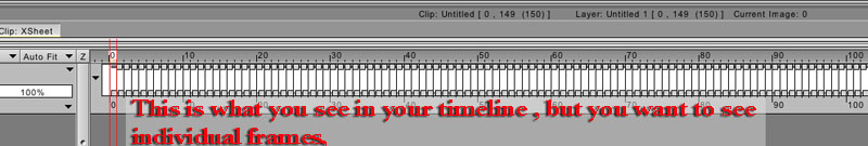

Now there seems to be another issue though. I was once able to view my timeline by frames 2,4,6,8,10,12 but now it's set at 0,20,40,60,80. Makes it a little hard to flip between individual frames. Is there any way to change it back?

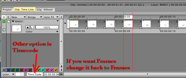

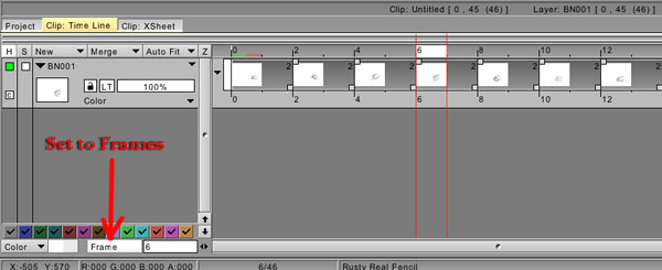

Make sure that at the lower left of the timeline panel it is set to FRAMES , not to TIME CODE.
*EDIT: Never mind , I misunderstood what you were asking about . See Malcooning's answer two posts below.

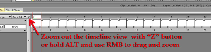

I think what doofusy described is simply an alteration of the zoom level. instead of individual frames he's now zoomed out and sees frames from a further out view.
Doofusy, you just need to zoom in on the timeline. Stand on the timeline panel, pres down ALT and use your Right-Mouse button to drag in/out the zoom, or instead use the 'Z' button at the beginning of the frames.

malcooning wrote:I think what doofusy described is simply an alteration of the zoom level. instead of individual frames he's now zoomed out and sees frames from a further out view.
Ah, yes , I believe you are correct. I misread doofusy's previous message describing the problem.
Doof, it's as Malcooning describes, like this:
