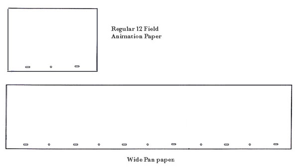

If the BG must pan behind the character layer then the BG layer will necessarily have wider dimensions. For instance if your normal project size (character layer) is 1280 w x 720 h then if you want a BG layer to pan behind the character your BG layer might be 3 or 4 times as wide as the normal project size (or wider if it's a really long pan move) . In traditional animation terms it would look something like this:
For example, let's say the BG layer which moves behind your character layer will be 3 x wide = 3840 w x 720 h .
So you have your BG drawn in a TVP project size 3840 w x 720 h . Then you also have your character animation TVP project (size 1280 x 720) open . Create a new layer underneath the character animation layer in this project. The new layer should be the same number of frames (blank frames) as the character animation layer above it. The new layer is where your BG will go.
