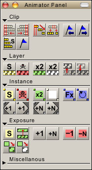

Destroy the old Animator panel and go to Windows => custom panel => to choose the new Animator Panel (which is like below : )
- animator panel.png (19.75 KiB) Viewed 16201 times

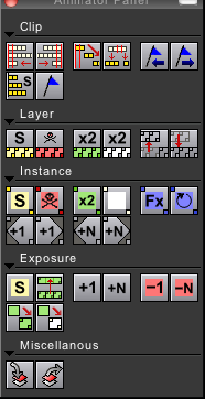

Mine looks the same:
and when I close it and open it again from the menu, I get the same (I checked the commands). I found no command to "destroy" or delete that panel.TVP 10.0.18 and 11.0 MacPro Quadcore 3GHz 16GB OS 10.6.8 Quicktime 7.6.6

The default configuration features the bright grey interface. When I hovered over the panel I detected a small triangle which I didn't spot in my own, dark grey UI ... and there's that option to erase the panel!
So the correct sequence is:
in TVP, RMD over the Animator panel, first line, This Panel > delete. Quit TVP. Open program package/Ressources/Plugins, remove whatever AnimatorPanel is there. Put in the correct one. Restart TVP: the new AnimatorPanel will load inside my own configuration. Much simpler!
