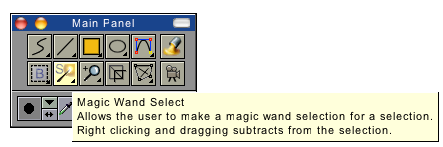

Slowtiger's suggestion is best (to save PNG file with transparent alpha then Open it in TVP) , but if you happen to find that you have imported an Overlay layer with the clear area around the Overlay object showing as opaque white area instead of clear , then you could also use the Magic Wand Selection Tool to select the white area around the Overlay and then hit Delete key to take it out. That would work, too , though it might make the cut out area around the Overlay look too sharp-edged depending on what it is, so you might need to soften the edges a bit. Experiment with the Expand and Smooth settings to get it to cut out the overlay the way you want it .
