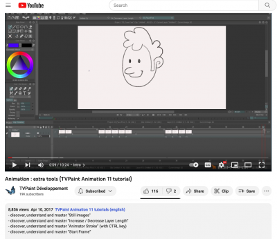

Posts: 4272
Re: FAUX FIXE
BinaryD00D wrote: 26 Jul 2023, 16:09 was this removed in TVP 11.7.1 ? I no longer have to option to faux-fix/repeat frames
As Leo mentions in the previous post , "Faux Fixe" is now named "Repeat Images" . It is covered in one of the video tutorials on TVPaint's YouTube Channel:
https://youtu.be/2oTe3JzMy6s?t=10
And a little bit of information in the User Guide , but I suggest watching the video.
https://www.tvpaint.com/doc/tvp11/index ... eat-images
TVPaint Support: About this video on YouTube - https://youtu.be/2oTe3JzMy6s?t=10
This tutorial explaining Repeat Images (or "Faux Fixe") is very helpful, but the video does not show up in YouTube search for either TVPaint Repeat Images or TVPaint Faux Fixe. The video description says:
- discover, understand and master "Still images"
- discover, understand and master “Increase / Decrease Layer Length”
- discover, understand and master “Animator Stroke” (with CTRL key)
- discover, understand and master “Start Frame”
but the description does not mention "Repeat Images" (or "Faux Fixe"), so many users looking for this information may pass by this video without watching it .
Instead of discover, understand and master "Still images" should it say: discover, understand and master "Repeat Images". ?
I think the video description needs to be updated to clearly mention the Repeat Images function . The description should also probably mention that Repeat Images was formerly known as "Faux Fixe" in older versions of TVPaint. (this is mentioned briefly in the video that Repeat Images was formerly called Faux Fixe , but it is not clear in the video description to anyone searching for a tutorial on how to use Repeat Images or Faux Fixe.)
Matthieu
Posts: 184
Joined: 11 Jan 2021, 13:10
Re: FAUX FIXE
Post by Matthieu »
Hello!
Good catch! I agree this prevents users from finding the video indeed. I have updated the description of this video tutorial, thank you :)
