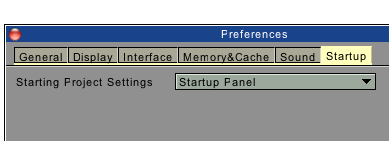

Re: Canon : TV Paint Application Crash
Please can you try to reset your configuration ?
( Edition > Preferences > + activate the "startup panel" in the last tab ) then restart the software and create a new config or delete the current one.
Also, there is ( Help > Check for update ) to make sure you have the 9.5.18 version of the product.

Fabrice wrote:Hello,
Fabrice,
Is that the fix for the video capture crashing issue , to create new config each time in Startup Panel ? As you can imagine this is a huge issue for me in giving advice to my online students using video capture in TVP for stop-motion and traditional pencil testing.
If the fix is to have Preferences set to "Startup Panel" instead of "Last Project Settings" or "Template" then would it be possible to update current version of TVP (9.5.18) so that the DEFAULT preference setting is always set on "Startup Panel" to avoid confusion ?
Fabrice,
Hi david,
Indeed, it's not intended to be a final solution/recommendation for your students. I just wanted to make sure that the bug was not linked with the current configuration of the software.
Having the "Default preference setting is always set on" is an option we plan to add in the future, because it was asked several time by teachers.
