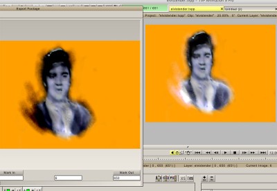

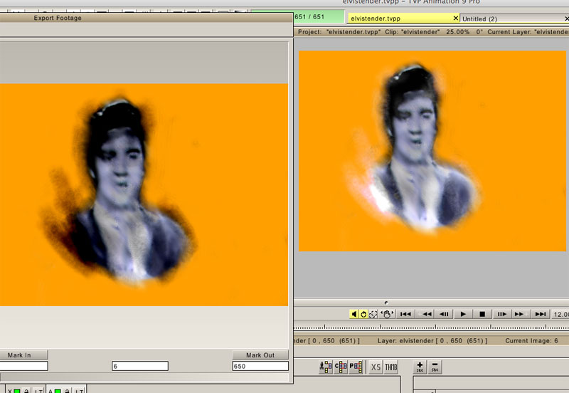

Hello, I've probably missed something, but my white color done with synthetic sponge renders black onto the final exported clip. Is there a way to change it to the right white color? Really have no idea about what might have happened. Look: on the left is what gets rendered, on the right is what I actually did and wish would look like. What is wrong? Thankyou.

have you tried to check/uncheck the BackGround gadget in the export panel ?
Posts: 2973
Re: White color renders black
Did you render with transparency? If so, switch between PreMultiply and No PreMultiply because they add black or white to half-transparent areas.
This is a tricky feature because no two programs seem to do it the same way. I always have to test export and import just to make sure.

Your solution worked! Thanks, I guess that I used a tool that doesn't actually paint, but "scratches" de layer. Cheers!!!!
