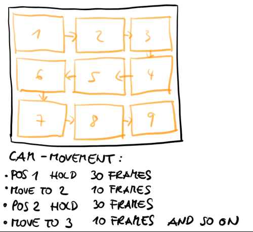

I need some hints to make a special camera movement. I tried different ways but never got any usable results. In this case it don't make sense to do the movement with the keyframer. So lets have a look to my attached sketch of the desired movement.
I will start on position 1 and will hold it for 30 frames. Then the cam should move for about 10 frames to position 2. Then hold the position again for 30 frames. Then moves to position 3 and so on. Everything should move linear - no slow in or slow out.
So I have 9 positions and 8 holds what makes a total of 350 frames.

well, I personally would go with the Keyframer to perform such a cam multi-movement :
the big project as source, the small one as target, the power (and accuracy) of the Keys on the timeline.
anyway, you can acheive that with the camera tool as well, here's my steps :
- make your full image project and make your clip length at 30+10 = 40frames,
- set your camera to center the "1", set a second camera position to fit the "2",
- set the speed-curve of the camera : flat to 0 on the first 3/4, straight oblique on the last 1/4 (see pict.),
- duplicate the Clip,
- mouse-point the first camera-frame and Delete the point, set a a second camera position to fit the "3",
- mouse-point the first camera-frame and Delete the point, set a a second camera position to fit the "4",
- duplicate the Clip, ... and so on until "9"
so you will get 9 clips : "hold 1 and go to 2", "hold 2 and go to 3", "hold 3 and go to 4", ... "hold 8 and go to 9", "hold 9",
each one with a simple cam mvt (A to B), easier to manage imo, below's the result, (no ease-in/out, no motion-blur) :

Wow,
this looks good. It seems to be a much better strategy to solve my problem. I don't want to use the keyframer here, because I am working on a kind of a "live animation performance" I will held at a party next week. I try to avoid too much technically aspects and want to concentrate on the drawings. I think your solution is practical for me, I will make a test tomorrow.
