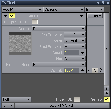

well, if it's only to preview the paper structure behind your current layer, you can check-on the paper gadget in the Display Settings window.
another "workaround" consist to add in the FX-Stack (without applying it) a Color/Image Source : Source = Paper, Blending Mode = Behind ,
when you want to see the paper in the background, check the FX-Stack Preview gadget On, when you don't, check it Off.

Hmm - the FX Stack idea is interesting - I'll have to check that out, thanks. :)
Slowtiger - the reason I wanted to have my paper image as a background rather than a layer was because I often use the toggle all/current layer visibility key when I'm drawing (it's mapped to a tablet button, that's how much I use it!), and obviously, when I'm on current, my paper texture disappears.
Edit - I like to use a paper texture (I don't mean the tiled ones - I mean a large image the size of the current project) as, for me, it feels more natural and nicer to draw with it showing - so the View Paper option isn't what I'm after, as the paper changes with each brush, and I've tried the FX Stack thing, but as you say, this only works for previewing what it looks like, not actually drawing.
