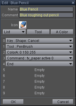

this issue could be fixed imo, I think when the custom tool is made of a custumbrush, it works directly, but when derived from an air/Pen/mechanical/pencil brush... (one of the first line of the tool panel), it requires an [enter] hit action before to get the tool "inking" effectively.Peter Wassink wrote:... i have one custom tool that works directly after using off-peg but most others don't, but i haven't figured out what causes it. maybe someone else knows?
to get rid of this, I've added a line Shape: Cancel (insert a command on top of the tool command) to all my custom drawing-tools which needed this trick,
exemple, my revised Blue Pencil of the Sketch Panel :
