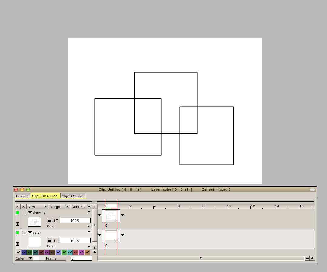

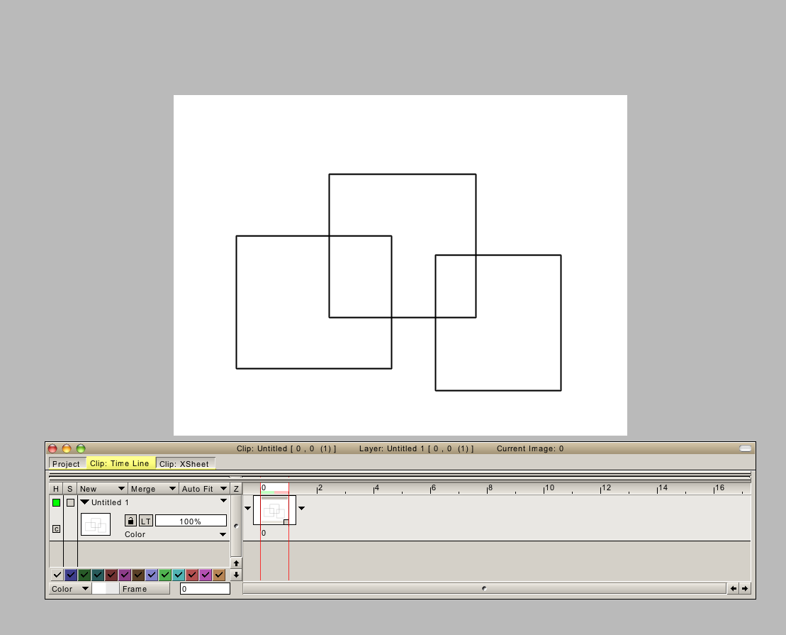

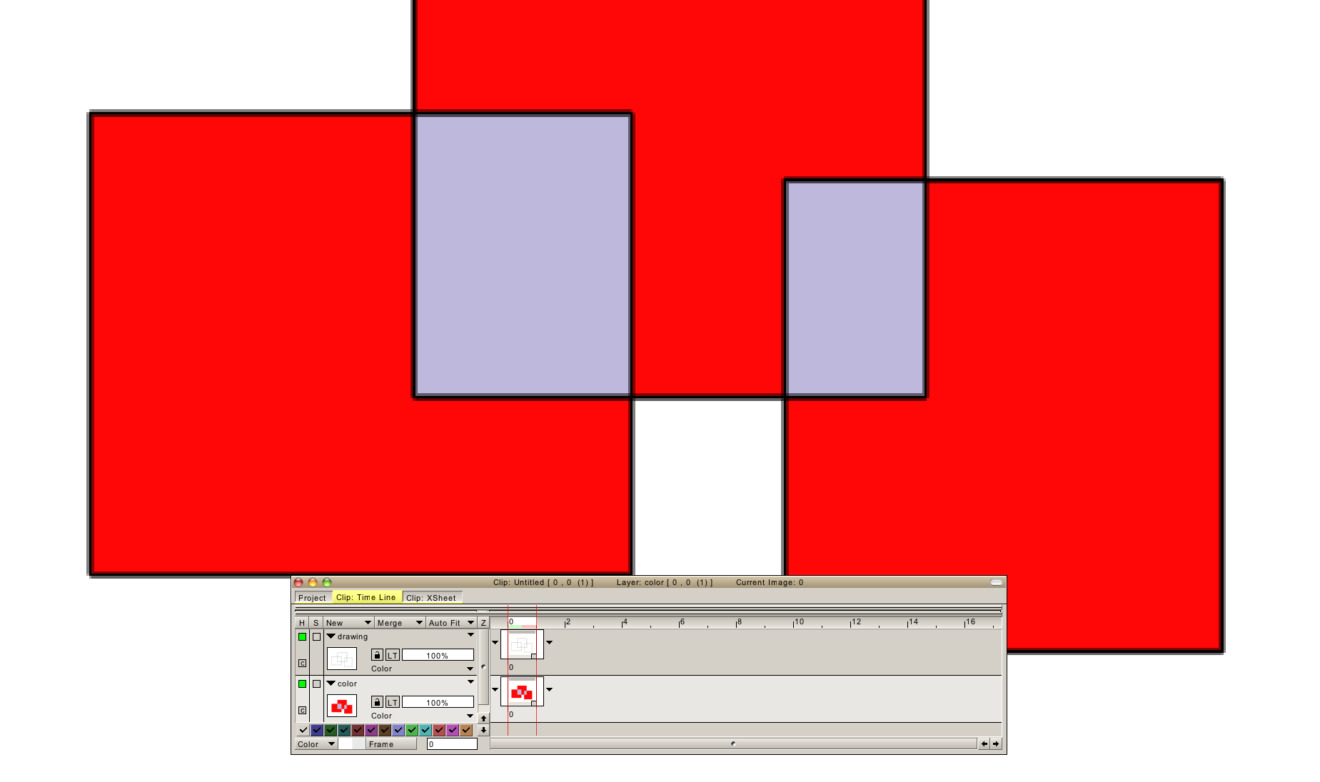

If I understood you well, you simply want to fill drawings, isn't it ?
So, make a drawing :
Create a new layer under this drawing :

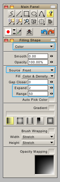

Take the Flood fill tool and configure it like this (for example) :
Be sure you've put the source "Front" =)
Then, fill your drawing. And as you can see, there are no "white" pixels =)
The Gap closer must be used when your drawing lines are not perfect (with little gaps). Exapnd will expand the flood of X pixels. The range is used when you want to take into account more colors and transparency to your flood fill. It's a little hard to explain, but make your own test : Take a photo and try to fill a zone with different range value : the more this value is high, the more the flood fill tool will take into account the different shades.

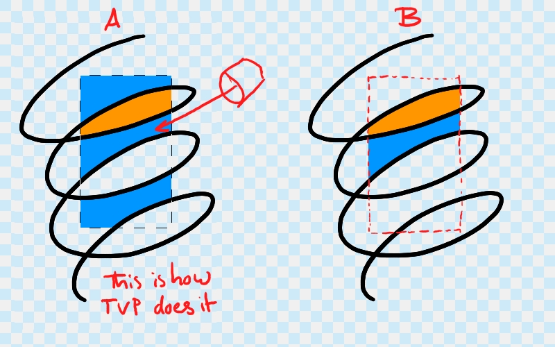

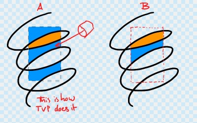

Re: Floodfill rectangle option
when filling a selection, the TVP fill tool still looks outside of the selection to see if in the whole of the project surface that drawing section is closed.
It just fills it as if the selection was NOT there and then only actually shows the fill where the selection is.
instead of using the selection edge as a border that closes off a section
in this example
i think Fran would like to see B happening, whereas now A is happening.
