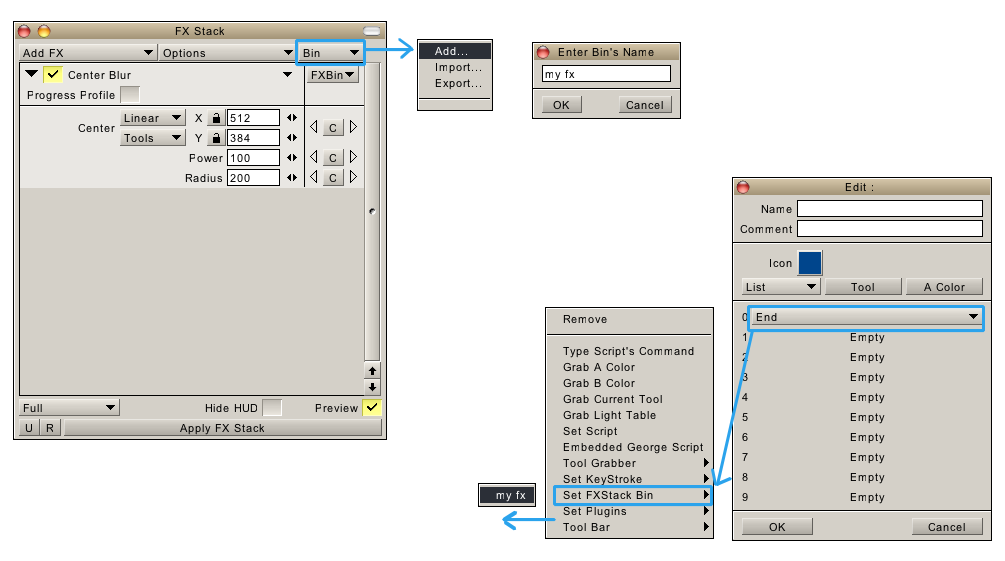

Re: Missing buttons in Animator Panel
It's possible, but the problem is the fx are saved with a project, so if you open a new project, your button won't keep the fx.
Do you still want to know how do this ? =)
Hop :
And then, add other functions in order to have something like this :
@Jesoped : thanks by the way ^^
Thank you !
It means, you just have to reload your fx when you open a new project…
… pas si mal, est-il ?
Is there an other accurate way to set the tools without using the fx tool ?
(… and to keep them from one project to another)
(script Georges ?… not for me
Sorry, I mean, if the custom panel with the fx button is opened in a new project with a new computer, the button won't keep the fx bin. Until you use your button with your own machine, the fx should be kept in memory. =)
Nope, it's not possible to set a FX in a George script.
