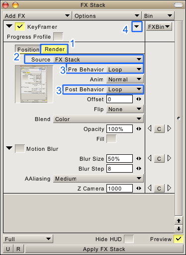

Create a new layer (and give it a duration by stretching the instance) and use the Keyframer :
FX => Motion => Keyframer
Then, in the render tab (1), choose as a source (2) the layer with your animation or an animated custom brush (select all your frames with the walk in loop, then use the custom brush cutter to cut your character => you will have a window, asking you if you agree to cut an animated custom brush => hit "Yes").
Always in the Keyframer parameters, don't forget to change the "Pre behavior" (3) and the "Post behavior" (3) in loop.
Then, on the little black triangle between "Keyframer" and "Bin FX" (4), click and choose "create a key" (don't forget to be at the begining of your layer).
Now go at the end of the layer and move manually your animation.
Each time you will modify the position, a key will be created.
So, if you want the character walks in loop in the middle of the screen, then it crosses the screen, I advise you to have a the start pose at the begining of your layer, then go at the frame X to create the same key again, then go at the end of your layer and move manually your character to make him leave the screen.
Of course, don't forget to select all your frames and apply the FX ! =)
