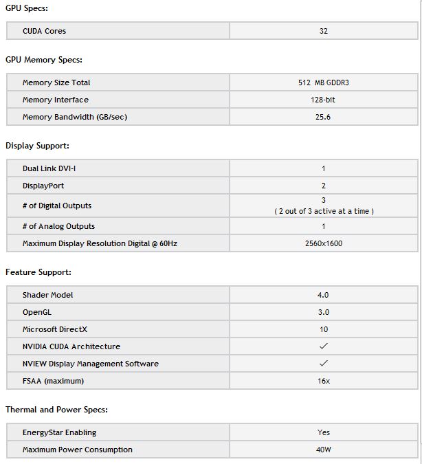

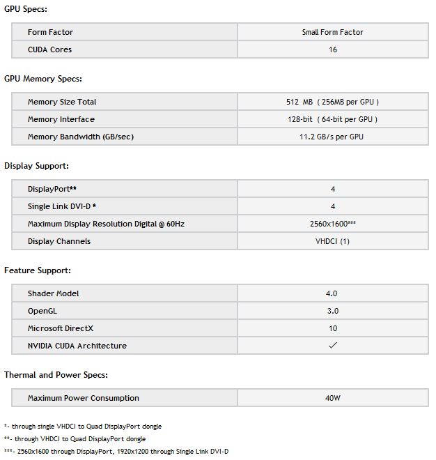

Well ,the cards have a lot of similarities, with slightly better features for the FX (apart from monitors number).
I only suggested this card judging by what Sewie was needing. I think the NVS card that you have is a great card, but is an overkill for most users. Since you drive 4 monitors you probably did the right choice. The Quadro FX can do only up to 3 monitors (2xHDMI, 1xDVI), which is not quite "only" for most uses (I'm just thinking of the added electricity bill...). I have an aging Quadro4 card in my desktop, and although it is dated now it did it's job very well, and could do only up to 2 monitors (well, we're talking a 2003 model card).
If you compare the specs, you can see that the FX has somewhat stronger features, while the NVS' advantage is the 4 monitors at high resolution:
Quadro NVS 420

QuadroFX 580
