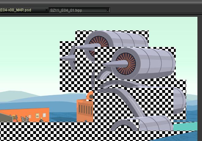

I don't know, but is this "normal"?
When I am opening a PSD (from CS3, Win7 PC) with some layers in TVPaint, TVpaint shows all the layers but mix them together. It's difficult to explain but take a look at the picture below. Every layer has some parts of the layers behind (under) it. I have a workaround to provide this. I export every single layer from PS and open and copy it to one TVPaint project, but that is a little bit inconvenient.
So, is this "normal" or do I have a kind of damage on my pc? The image shows the content of one layer.

hi Animark,
can you upload a .PSD file which causing you this wrong (flattened) import ?

This bug is fixed in the last update 9.5.11

Ah, yes, updating is much easier than exporting every single layer ;-)
It is working now. Thanks a lot!
