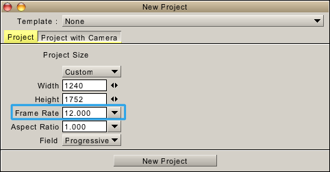

Ami wrote:- If I want to animate with "twos", do i do it in animation mode or in xsheet? (i can't decrease the playback to 12 fps cause it has to be synced to music)
If you want to animate in double frame you can manually double the frames like this, like Zig has just explained :
Or, when you create the project for the first time, change the speed as 12 fps :
If you change the playback speed in the remote, the sound cannot follow and you don't here

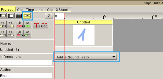

Ami wrote:- Should i do kind of an animatik first, to try to sketch the main points to match the music. do i do it with the storboard tool? can i have music there?
Well, it's not useless =)
If you want to load the music on the animatic go here :

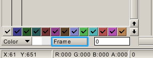

Ami wrote:-Are there some sound settings, I'm afraid it plays the music too fast (should be 25fps). Or can i change the frames into seconds to see the speed of the sound clip.
Ami
You only can make fade in and fade out with sounds. If you want to use the time value, please just click on the word "frame", here :
It will turn into "Time code"
