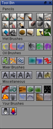

Has anyone had any luck opening this in TVP Pro 9.5.5? After I bring the tvpx over to TVP and open, I find nothing in the menu of Custom Panels -- unless I'm missing its name or something. I even tried Force reloading to no avail.For people who want to use again the old TVP Animation 8.6's Tool bin, you find it here.
To know how to install it, please have a look on this topic.

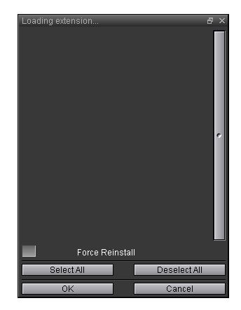

I've tested it, because I wanted to know how the old tools are looking. But I had the same problem like you. I only got an empty "Loading Extensions" window, but no tools. Also using "Force Reinstall" don't brings the tools.
- LoadingNothing.JPG (19.71 KiB) Viewed 21903 times

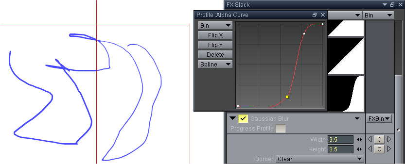

yeap, to make a line thicker (add border), we have decimal increments, but it's not the case to make a line thiner, Erode_fx settings have only entire num incrementsPaul Fierlinger wrote:... Erode makes the line thinner in big increments -- Line Tweak somehow eroded my lines in a gentler way (maybe) .. .
note : we have also an other (alternative) way to erode a line work, blur it and adjust the Alpha curve,
a workaround not perfect, but it works fine in some cases .
- erodewa.png (28.22 KiB) Viewed 21800 times
Re: old TVP Animation 8.6's Tool bin
How do you bring in the Alpha curve? I don't see it anywhere in the Gaussian Blur.
not present in the blur FX itself, but add a new FX in the stack (Color/Curves RGBA).Paul Fierlinger wrote:How do you bring in the Alpha curve? I don't see it anywhere in the Gaussian Blur.

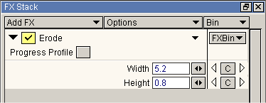

that said, I've added these Erode requests in my list some times ago :
- sepate x and y values
- decimal available
maybe it's time to raise it up again, in perspective of the next V10 !
- erode-request.png (3.16 KiB) Viewed 21862 times

Well, that's strange, because it does work on my 9.5...Animark wrote:Hi Paul,
Did you first select "force reinstall" and then, had a look in "Windows => Custom Panels => tvp_8_6s_tool_bin" ?
Hi Elodie,
yes, I tried all possibilities. Everytime the install window is empty, like the screenshot i posted before. But don't worry about it, I just wanted to take a look at that tools.
