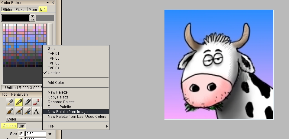

Already done.I also loved a function in the past I've found in C.T.P. (Cartoon Television Program) and in Animo. There for example you can put a whole colored character in a kind of a palette. The brush/bucket changes to a pipette when its above the palette and grabs the color on mouseclick. Then the cursors comes back to the tool you used before (e.g. the bucket) and you can color the next part of the drawings. It is an very intuitive and fast way to find the right colors for your character, even when you worked the hole day in front of a screen.
Re: Can palettes be locked?
Mhm, "New palette from Image" was not what I tried to discribed. Imagine it more in a way like putting an image inside the color picker panel. You can see the image there everytime an you can pick up every color of it. Clicking on the nose chooses the nose color, clicking on the eye chooses the eye color and so on.

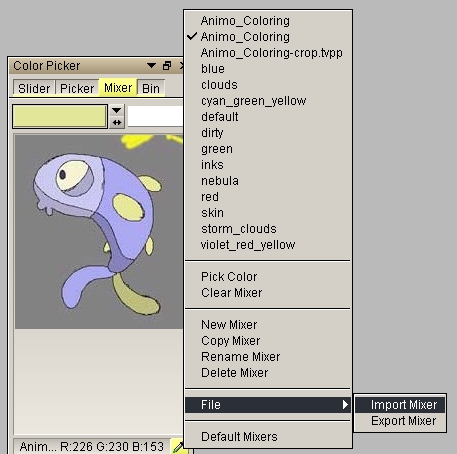

you can do it in 9.5 by importing a jpg into the color mixer (see image)
just make sure the color picker (bottom right) is active (yellow) and you can "pick and paint"
small problem with it though: you do need to prepare the palette image, if the palette image is to big, you only see the left side of it.
