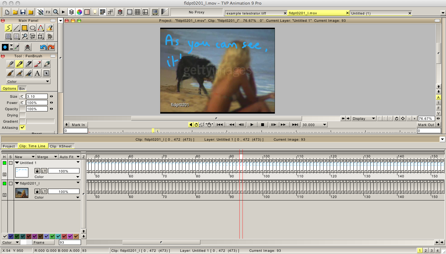

Of course it's possible to draw above a video in TVP animation. In fact, when loading a movie with TVP animation, the movie is cut in several frames. So you just creat a layer above and you can draw above. (you can also draw on the movie, but if you make a mistake, you couldn't easily erase =p)
An example :
Here I have an example with the movie under and the text above. It gives me that :
example telestrator.mov
(2.18 MiB) Downloaded 1270 times
Don't hesitate if you have other questions

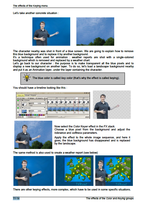

If you want to make something like the weather forecast (with, for example, a green or blue screen), you can use the color keyer.
This effect is too complex (and we don't have any blue screen here :mrgreen: ), so have a look on our user guide, lesson 11-14 :
