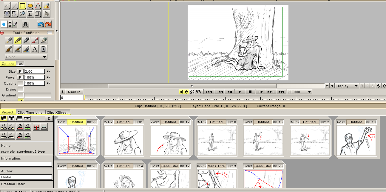

Hi everybody,
This tutorial will just inform you about how export and print your storyboard (If you want more informations about he project tab, please download the Appendix). Keep in mind you cannot directly print the storyboard. You must first create a .html file. Then you will open it with your web navigator and print it. Feel free to download this example to make your own test : http://www.tvpaint.com/forum_attachment ... oard2.tvpp" onclick="window.open(this.href);return false;

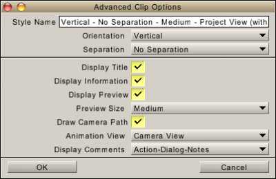

As you can see, there are 3 default view : an Occidental view (with column), a Japanese view (with strips) and a thumbnail view. You can choose the three (so, you will export three different views), or only choose one (in that case, the Occidental view). You can modify those default views (by clicking on the "..." icon) or create another one (by clicking on "Add a new style"). When you will modify or create another view, this window will appear :
Into this window, you can :
-name the style (you can save several styles)
-choose the orientation : vertical (occidental way) or horizontal (oriental way)
-choose the separation when using vertical mode : without separation (like a traditional storyboard), with one clip by line or an entire scene by line (limited to the print format)
Then, you can define the other options will be printed or not :
-name and informations
-the thumbnails' size
-the camera's path
-which point of view you want (camera or project)
-and which comments you need (action, dialog, notes, all of them, none of them or just some of them).
