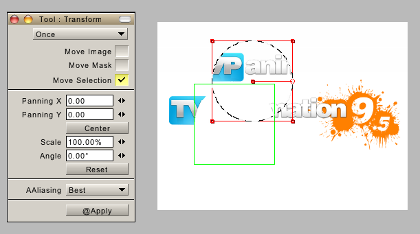

when using the transform tool, you can also only move a selection. (and apply the transformation on other layers)
