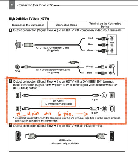

Is the listed "Component Cable CTC-100/S" a firewire (IEEE 1394) cable or do you need to buy the IEEE 1394 cable separately ? I think you'll need to buy that separately. For TVP (or most any other animation frame-capture app) to be able to capture video frames through the lens of a digital video camera it needs to be connected via firewire/IEEE 1394 . USB connection or otherwise doesn't have the live-video feed that is needed to capture frames one at a time. The cable will probably be a 4 pin to 6 pin Firewire cable (but check your camera manual and computer ports to verify that).
Oh, by the way , I just took a quick look at the Canon Vixia HV40 user manual posted on the Canon Support site. The relevant info. is on Page 72.
You do need to purchase a 4 pin to 6 pin firewire/IEEE 1394 dv-out cable .
This will let your Canon Vixia dv camera "talk" to TVP in a way that allows frame-by-frame capture using the TVP Video Grabber.
You can buy the IEEE 1394 cable at a local computer/electronics store like Best Buy or the Apple Store or online :

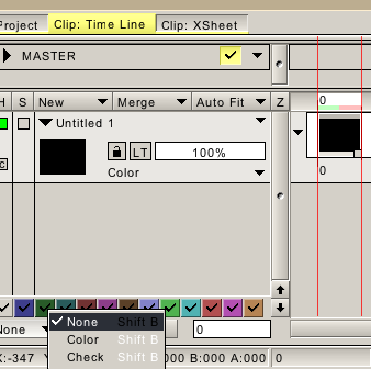

Everything else is as in the tutorial ? The little "V" button on the main project window is enabled ? (on lower-right side of project window)
At lower left corner of the Layer/Timeline Panel the Background is changed from Color to "None" ?
Re: Canon Vixia HV40 camcorder, Mac combatibilty?
Yes, I have the "V" selected and Color is set to "none". I moved the file back and I'm staring at myself again
