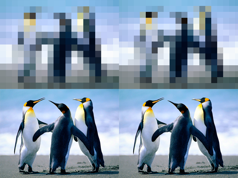

in a second too, but in tvpa (enter "20" for the block's size + hit "apply") :malcooning wrote:If you have After Effects, you can simply apply the mosaic FX.
nothing much to it.
I made this in a sec:
to compare, left side = AE, right side = tvpa,
slightly different result, but not worse (maybe better because more contrasted).
