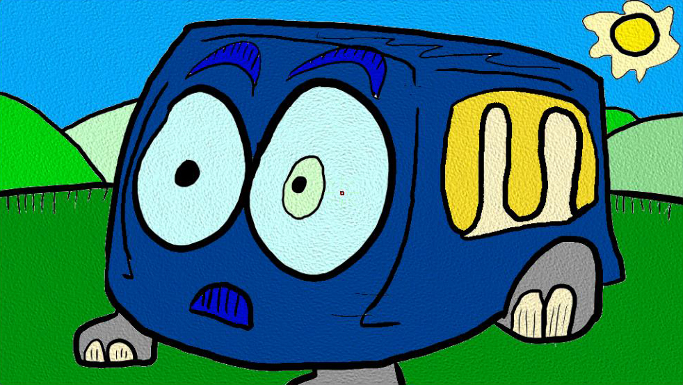

I've worked out a way to do it though! I drew out the linework, then FloodFilled flat colours where needed on the same layer, then I turned on the paper and then: Effects -> Distortion -> Bump -> Changed the Source to Paper05 and lastly the Depth to 300 and applied it.
Here's a quick example I made to demonstrate what it looks like
