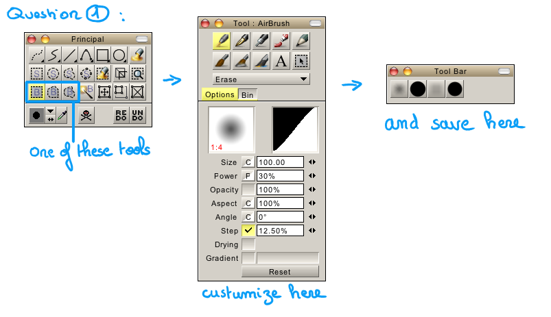

1. To create a brush, use the icon with a "B" into the Main Panel, custumize it below and save it. To save it, open "Windows" => "Custom Panel" => "New tool bar"

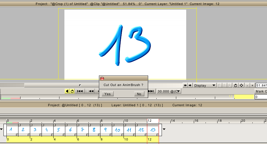

3. Many brushes can be found on the forum, into "Content Sharing". We also sell a Creation Pack with many brushes, paper, plug-ins etc... And of course, you can modify tool bin's brushes like I've shown you just above. You can also create "animated brushes". To do it, make a simple animation on several frames, select them all, use a "B" icon, and a window will appear => "Cut out an animated brush"

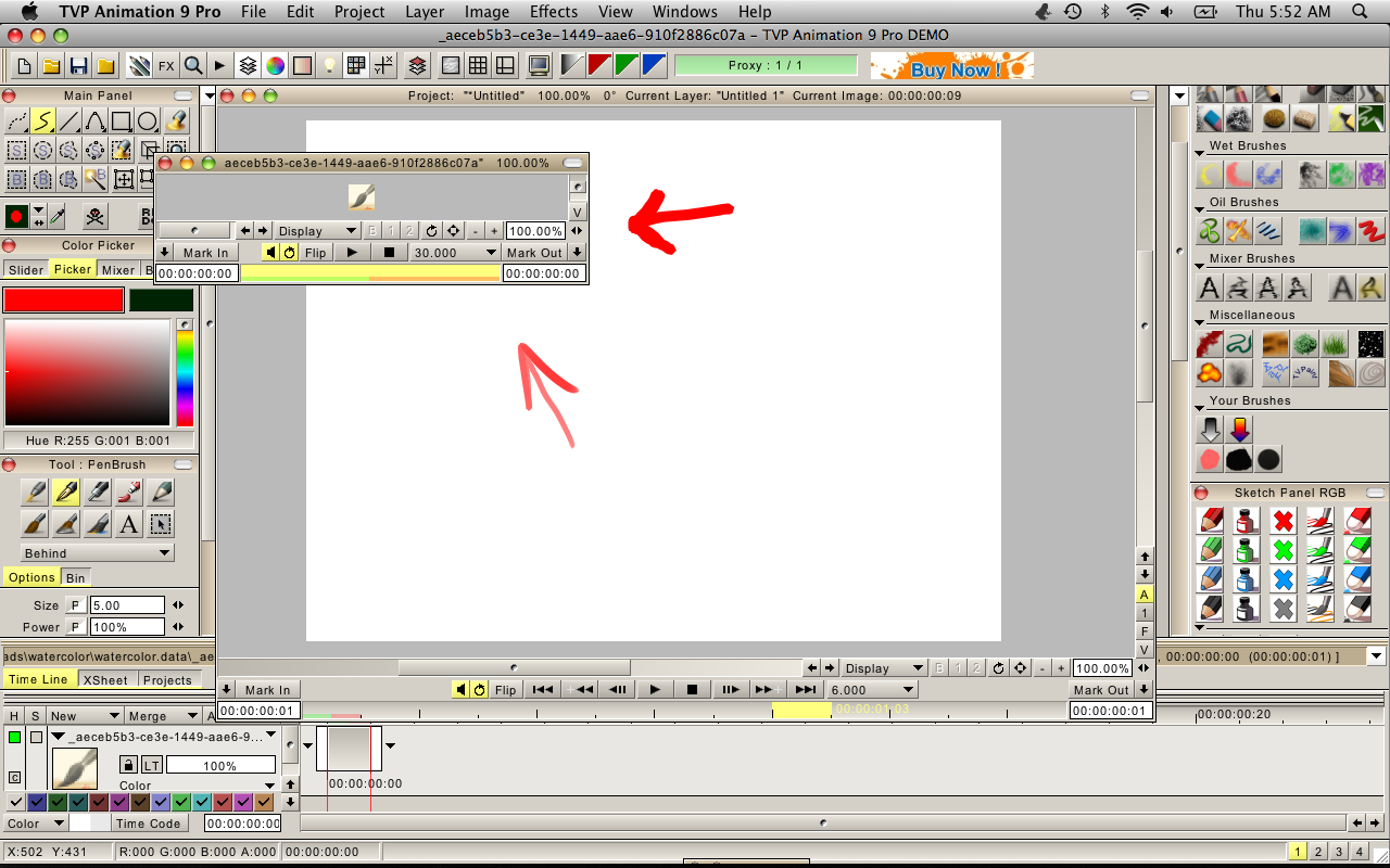

ok so here's the window I get when I do the steps that you posted. It's like an extra canvas window or something.
- Picture 1.png (19.11 KiB) Viewed 28682 times
Re: I'm new to TVPaint, please help!
Ah ! You have imported the icon, not the panel ^^
First, which sort of brush have you downloaded ? A .bin or a .tvpx ? =)
OMG! There we go! It works now. I was importing the icons. I imported the bin files and they popped right in. HAHA! I haven't tried the tvpx one yet. Is it the same thing as a .bin file? Thanks a lot. These brushes are cool! I'm gonna try to download more now. I really appreciate you getting back to me so quickly. If I have more questions I won't hesitate to ask. Thanks Elodie!
