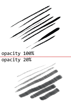

Hello dear TVPaint friends,
I have been trying to make an calligraphy brush for inking purposes. I tried it by using a custombrush I made. But when I used it for drawing I noticed the ink line was not consistently black when I applied light pressure with my Wacom (Intuos 3). The line keeps getting broken and this occurs only when I apply light pressure.
When I change the brush opacity to around 20% and apply hard pressure I get different opacity thicknesses in the line. It isn't consistenly gray as (I think) it should be. See the gray horizontal line at the bottom of the screenshot I included. The format I drew this on was pretty big: 4800x3090. I occasionally need those kind of sizes for layouts and I used this as a test. The screenshot, of course, is cropped (not resized) and the paper-button was disabled.
Now I was wondering if, and how, I could get these ink dabs and opacity-inconsistencies to disappear ? I am wondering if any of you working on different hardware configurations have the same problem as I have with this brush? Lately I switched to a 64bit VISTA machine and I am wondering if that might be the problem...
I have attached the custombrush I used and a screenshot of the toolpanel with the settings I used. I am aware that the "step" option is turned on, but even with that option off I keep getting these ink-dabs. Hope someone can shed some light on this for me...

i was a bit too quick with my reply.
it turns out i have the same problem as Michael with this brush.
its just that you only notice the effect in the lowest pressure range.
but the problem is there also in the other pressure ranges,
if you set the opacity to 20% you'll notice that the irregular pattern is present throughout the whole line

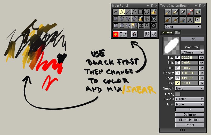

Re: Broken lines with custombrush ?
It works fine here as well. I like what it does in combination with two colors in the A and B pen with @smear applied. I'm keeping it. Thanks.

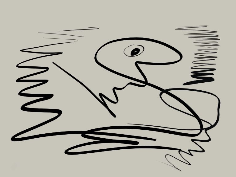

Hmmm. I set the opacity to 20% P and just get a grey with darker color in the loops where the brush steps over itself; nothing like you guys are showing. I'd say it still works here.
TestingMike

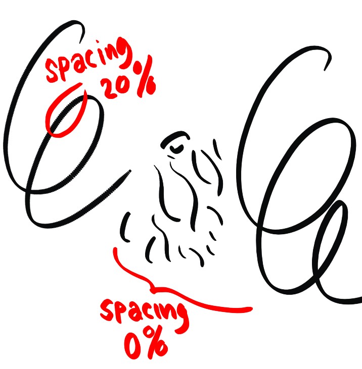

TestingMike-2

Paul, @smear is only in the beta version, not in the public version, ... :oops:

...I don't seem to have that option.. Is it only for beta-testers ? Or a plugin ?

ZigOtto wrote:Paul, @smear is only in the beta version, not in the public version, ... :oops:
Ah ! Zig was faster than I was. But..damn ! That's a great option !
Me wanna....

Sewie wrote:Can that beta version be the reason Paul is getting better results with my brush ? If so; is the paint engine changed and improved in the update/upgrade ?
no, I've tested your custom brush on v9.0.4 and it works fine, like in Paul's test .
I rather think it's a last wacom driver matter, I have a v4.78.6 and a wacom2 ... and no broken lines (see pict.)
